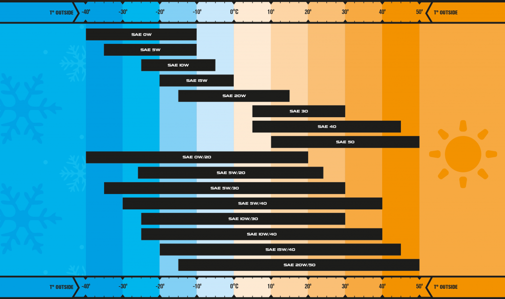

The word should first be changed from REQUIERED to Recommend. This is important because choosing the oil viscosity also has a lot to do with the engines operating environment. Looking at your area.... Weather history for Valley, Pennsylvania, the use of either would work fine for a daily driver. If you look at the specification of each of the 2 MAZDA recommend oil types, they are very close and would only exceed their limit of "protection" on extreme engine use or operating environments.
Please look up the correct information and terminology about oil and what it means.
The basic meaning of oil viscosity is oil flow specifications not really thicker, thinner or heavy and light.
Below is a VERY basic operation temperature chart. This does not indicate "OIL FLASH Temperature" which should be considered if any engine is operated in performance or very high engines speeds for a long period of time. In other words, NOT a daily driven vehicle.
