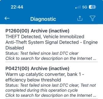

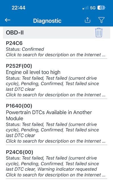

I put a cheap OBD2 reader on just to see what information I could gather regarding the engine management light, naturally it did kick up a code related to the high oil level. There were also additional codes which I will put below as well as a picture, a quick google for each of them and the alleged most common cause for multiple is some form of sensor malfunction. I did want to ask for advice regarding getting a reasonably priced and recommended OBD2 reader and program or app for Mazda. I just used a cheap generic one that I had lying around, I couldn't get it to connect to the paid for app FORScan lite on Iphone and ended up using the free car scanner Iphone app instead.
The codes are as follows:
P24C6 (00) - From what I read this is linked to a faulty particulate matter sensor
P252F (00) - This is the high engine oil code, most commonly caused by diesel fuel dilution from failed or interrupted regeneration attempts
P1640 (00) - I was a little more stumped with this one, it seems to indicate that powertrain DTCs are available in another control module such as the dosing control unit. My little scanner wouldn't read the DCU. common causes allege to be faulty NOx sensor or issues with the DEF/UREA system.
P1260 (00) - This is an archived code that I think is just perhaps related to when the key battery was on its way out and needed replacing
P0421 (00) - This one is another archived code but has me the most concerned. Google informs me that its common causes are either a failing catalytic converter, possible exhaust leak or yet another possible sensor issue, this time one of the O2 sensors.

Honestly with that many DTC and likely more you don't know how to locate you need to go to a service shop that has a Certiidife Diagnostic Technician and have them scan your ECU and give to a short run data log and then give you an assessment. I also see that you have some DTC that are older than other and likely caused the DTC to activate them which convolutes more of finding the root cause.
I do strongly suggest that you do not replace any parts or do any cleaning of them unless you know how to check them first! You will more than likely cause additional unresolved issued that will just add to more problems.
Its not about the scanner you are using (unless it is a blue tooth type) but that you don't have the learned skills. If it were then simple, then we could all be doctors.
