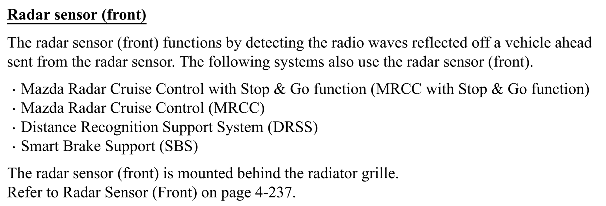

According to the manual none of the features I mentioned use the front radar sensor
