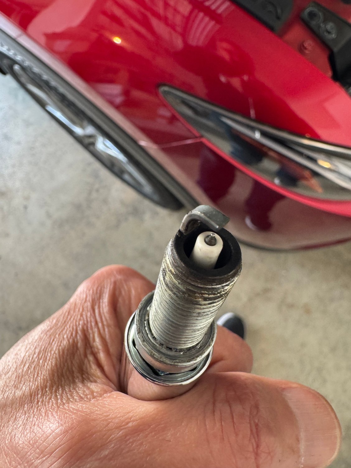

Thank you for the detailed response, Callisto. That was very informative and interesting. Since I wrote this, I’ve been tracking my fuel consumption rate and it has increase by 3.5 mpg! Not trivial. I also replaced the 8 coils on my 5.7L Hemi Jeep with 150,000 miles along with the spark plug wires with amazing results (I used NGK vs Mopar). Everything you’ve said definitely is right on in that we think these coils are just fine and last a lifetime but they really don’t. And all those different failure modes. I’ve always wanted an automotive scope but they’re probably pretty expensive. When I was trying to install cylinder number 4’s coil on the Mazda, it wasn’t seating so I took off the plug thinking maybe there was some interference. I noticed the plug was black on the bottom round rim, basically carbon from unburnt fuel. Should I replace those plugs?

Can u provide a couple of pictures?

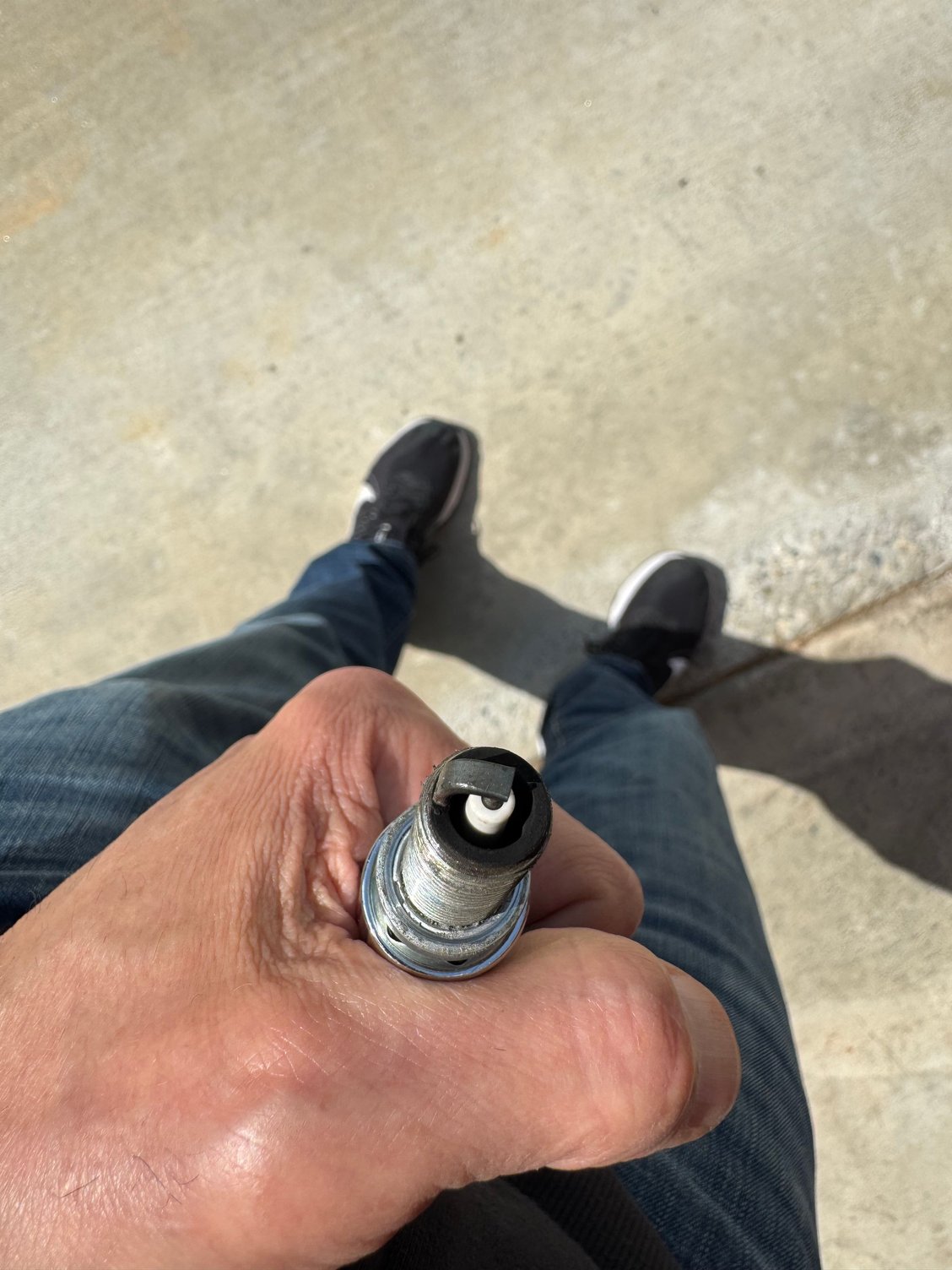

Here ya go! Picture of cylinder # 3 spark plug that has 5000 miles.

The plug may be on the rich side but then it depends on how long the engine is run at low RPM and also how many seconds it idled before you pulled it. In which case the other indicator would be normal fueling and timing and not a mechanical concern.
Dielectric grease needs to be used sparingly and properly to do the correct protection but nut cause an electric barrier.
look at the last page of my thread
https://www.mazdaforum.com/forum/maz...like-do-44018/
Back to the plugs, if the other plugs all looked like this then you should be ok. But if not then you should do at least a compression test on all cylinders. If you do that make sure that all the cylinder do no more then 5 rotations no more and no less to be accurate and accurate to compare .
If the highest comparing the lowest is more then 10 lbs I would consider to do a leak down test as well

Thank you, Challisto! All the plugs look the same so, good for now …
