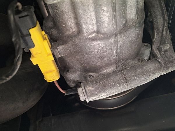

Old Sep 22, 2025 | 11:10 AM
Posts: 10,626
Likes: 231
Its not coolant. this I am sure of looking at the pictures. Nor do I believe another problematic substance other then it is fugly looking for an engine compartment
If it is powdery to the touch, then this can happen from the vehcle parked on a wet or moist surface and the cooled generally in the morning at sunrise then in some area's of the world as the sun continues to raise and warms the ground the that moisture will enter the engine compartment and basically everything under the vehicle but in the case of engine compartment this warmed moist air creates an under-hood environment the reacts to and causes that powdery substance to form on everything. Most of us have likely seen this more often on a vehcle parked for some time and the brakes and suspension can have this same white powdery substance but many only see the oxidation and rust instead of that powder.
Rinse the engine off with a garden hose and use a wide sprat not the high pressure. Then any remaining powder can by wiped off. You can use and engine wipe that will bring back the looks of the rubber and aluminum and other under hood parts. This can also happen even with garage kept vehicles under similar circumstances. Remember let the wet engine dry for a while before attempting to start it. Thios will prevent the effects of condensation to form in electrical components.
If the white powder is left to long it can discolor some parts like aluminum.
Below is the after effect of what I described, while it looks bad the aluminum can easily be shined back up with a little NEVER DULL polish cleaner.
Sorry I don't have an engine picture that I can find right now that will look almost exactly like the picture in the first post.

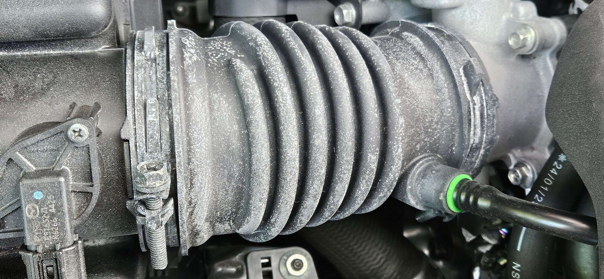

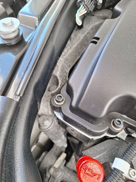

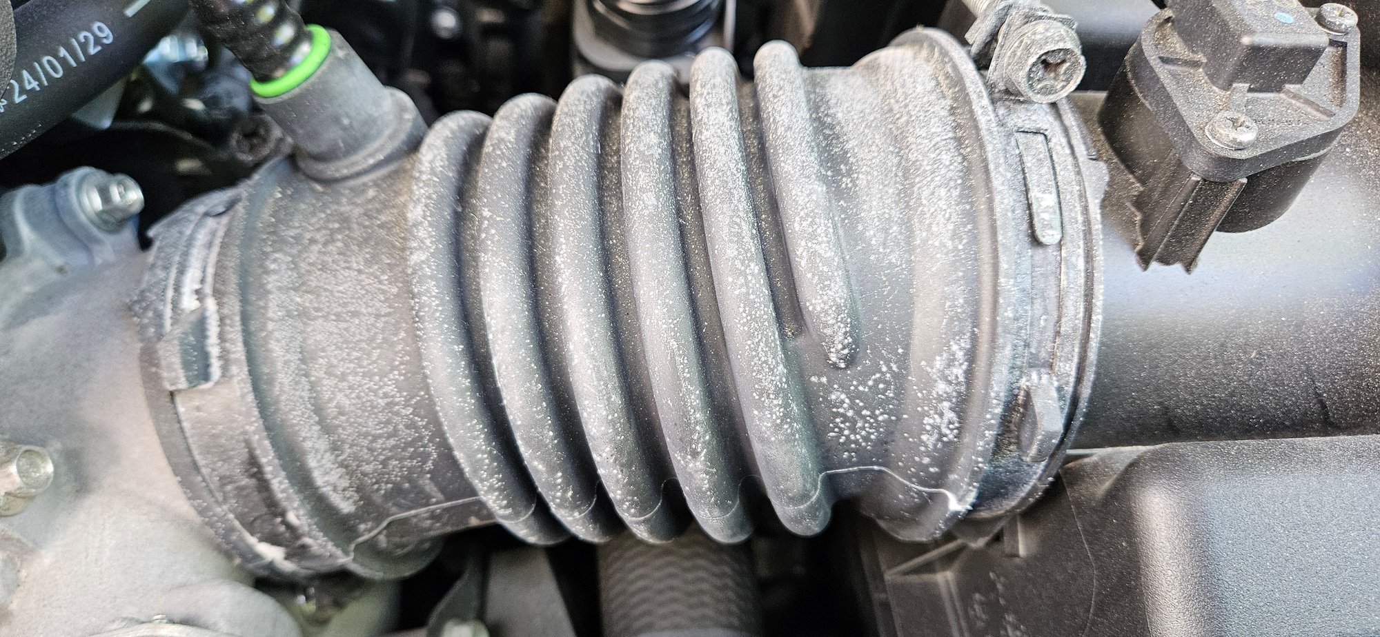

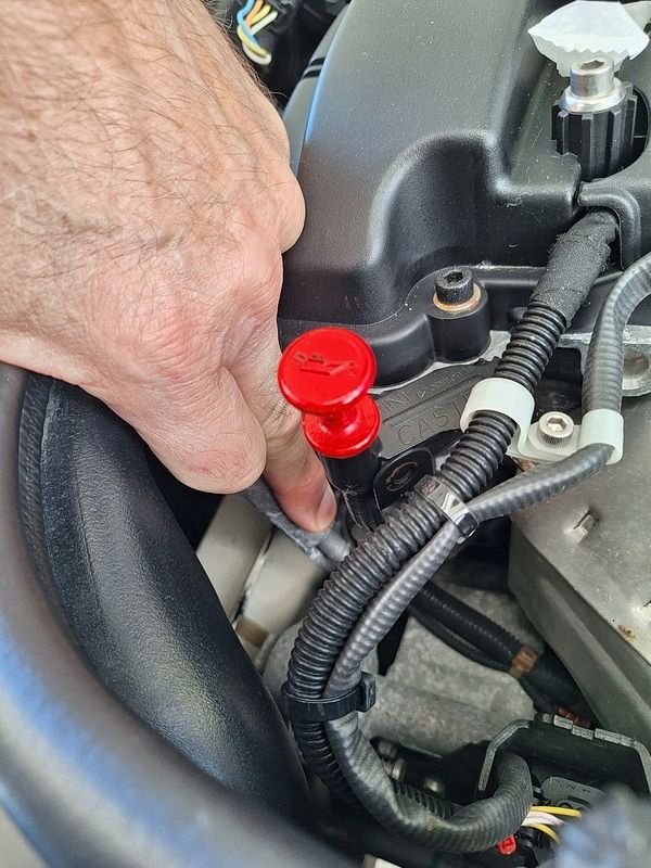

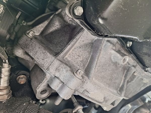

Old Sep 22, 2025 | 11:59 AM
Posts: 10,626
Likes: 231
Originally Posted by Maderd
Thanks for the detailed reply Callisto
It's definitely gritty...I would not call it powdery. I'll look at it again tonight and post what I find!
Thanks!
Yes I suppose we can call it gritty as well. Nevertheless it is more common that many think.
So I went out and just took these pictures. As a simple example, my engine compartment at the beginning of summer looked like your Mazda engine compartment. I live in Northen CA. I have since washed the engine a few times as well the undercarriage and removed most of the white substance. If I had to guess based on feel and touch it is byproduct of minerals formed from the moist and warmed air that can be under special conditions formed. Never really though to run it over to the lab for analysis. HA! I still have some remaining area's I need to cleaned up.
These are all after the rinsing and some minor detailing
I suppose feeling it for response info it does feel a bit grain like?
The under carriage I sprayed with simple green and then with a garden hose and universal common sprayer rinsed it off.
one last thing do not taste for salt. Aside from many mineral deposits can taste salty some are actually poisonous.
