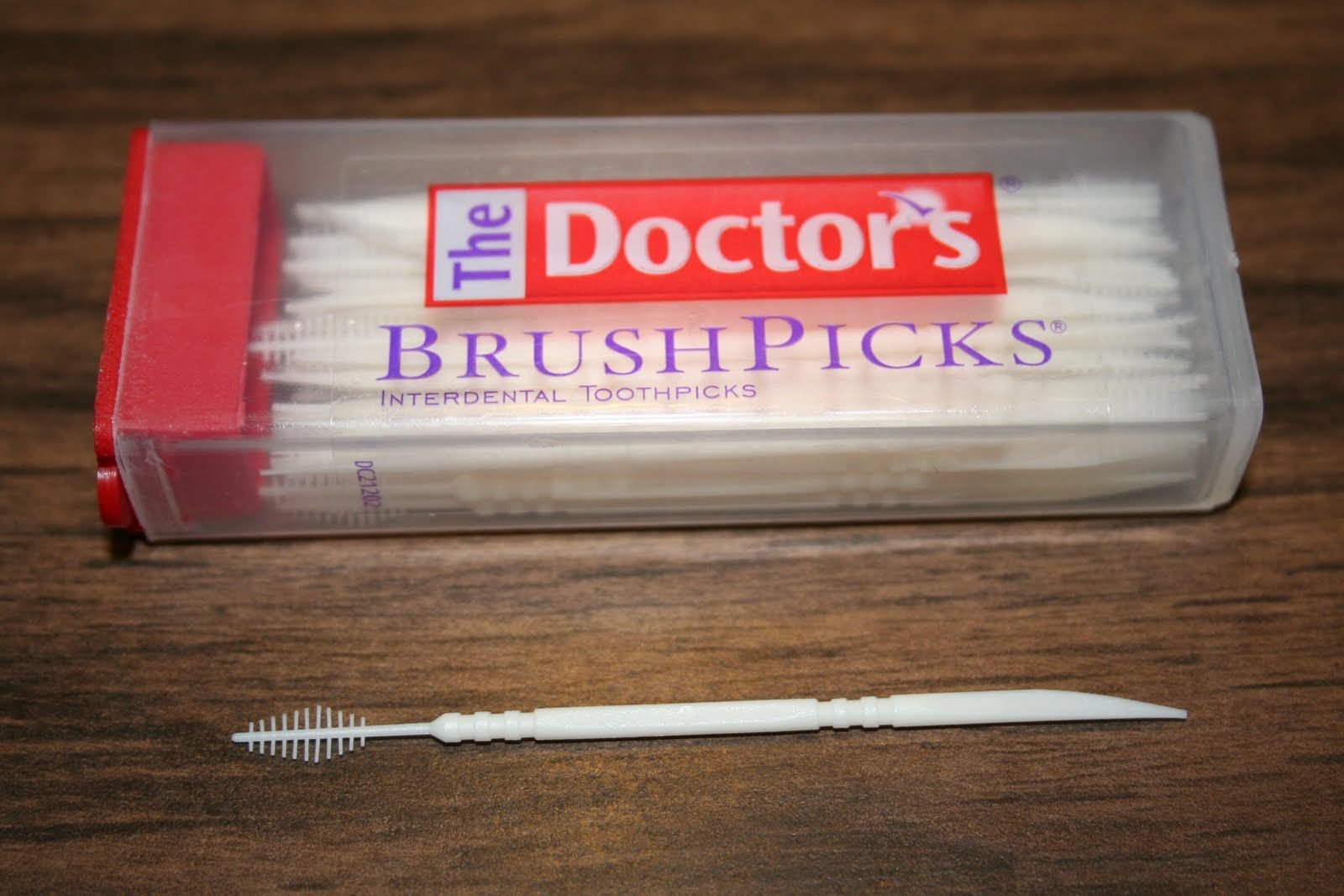

Posted about this today on a different thread but mine has stopped doing that since I cleaned out the iphone's lightning port with one of these:
