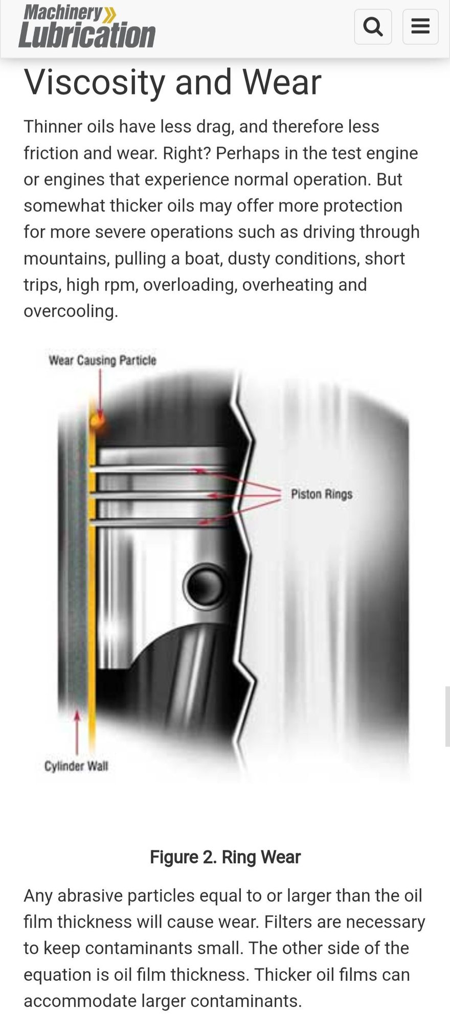

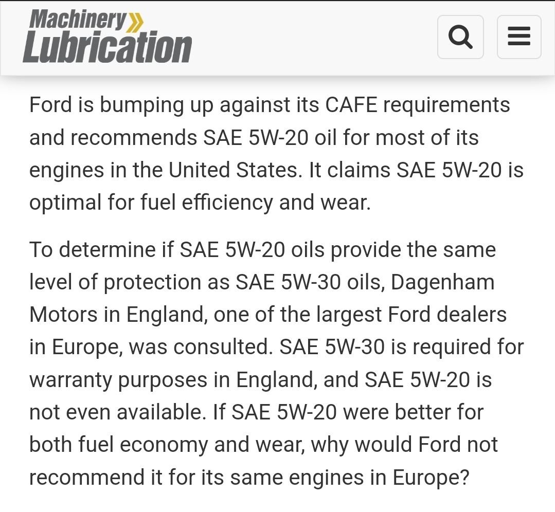

it all comes down to fleet wide CAFE standards.

Originally Posted by HighCompression
Maybe i am reading this wrong, but doesn't this Mazda manual say you can use a 40 weight?
LOL.
My manual says use only 0W-20 in USA ...and it says "only". And mexico and other countries it has 5W-30...
No 40 weight in my manual.

I think the main problem is that people have no frame of reference when it comes to oil weights.
If people were to pour some 5w20 weight and 5w40 weight oil into beakers. Heated them both up on a hot plate to 200°F, then got to put a stick in the oil and stir it, and pour them both out of the beaker and saw the viscosity differences, people would go "oh that really isn't much of a difference"
Then if you show them the inside of an engine and the plain Main bearings, and the plain big end rod bearings, and that big heavy crank spinning around at 6,000 RPM. They would have a better understanding.
Most people just look at the number and go well one is 20 and one is 40 that's a really big difference your engine's going to blow up.
