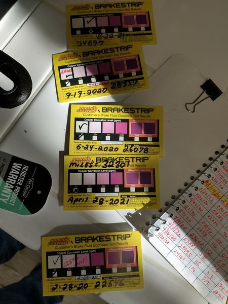

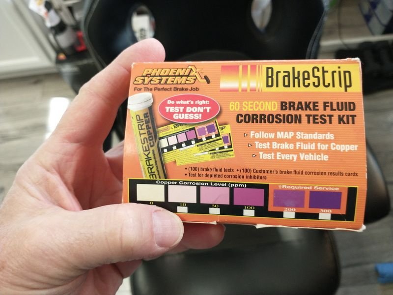

Brake fluid should be done every 2yrs 24k no matter what? Not feeling you on this one. They have fluid tester strips which tell you if your fluid needs renewing. I have a mechanic friend (worked a dealership for his entire life and recently retired) who recommends using the strips rather than just replacing by time/mileage.
If you like spending money for your own piece of mind, great, but that doesn't make the service necessary, or more importantly recommended by the manufacturer.
Dude the strips DO NOT indicate anything except the copper corrosion level .
I use them all the time and have posted their value to use many times on every forum I participate on! .
ROLMAO
