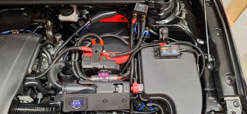

While my Mazda is a 2018 The ECU charging tables are exactly the same. I run an AGM Optima RED with a Power Bastards 250amp total @1200RPM on demand with 125amp at idle . I did not need to adjust and calibration in the ECU charging table to run this setup.
There is no factory Mazda that needs anywhere close to this much charging power but I also do not have a factory sound system either.
