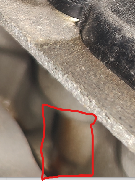

head crack behind cylinder # 3
Here is pic of crack behind cylinder 3. you can see the oil streaming out of the crack

Sorry maybe a poor picture lacking better detail but where is this crack that is pouring oil from? Looks more like a valve cover problem. But I will wait and see what you can clear up?
FInd the screw on the valve cover, then look below. Zoom in for clearer view. They replaced the whole cylinder head. Was smoking pretty bad and sparking on top of manifold the night before. Doesn't leak immediately at startup . Need to leave run s minute or two then it's starts streaming out. Was hard to stretch and take pics. And had to be quick before it caught fire. Had it towed to dealer.

Hmm I don't see it? I do see a wet valve cover possibly leaking?

close cracked cylinder oil leak
Hmmm. Why does your picture of the head look so much cleaner than mine? Something doesn't seem right?
