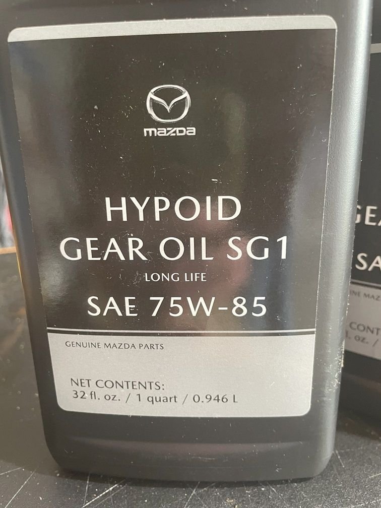

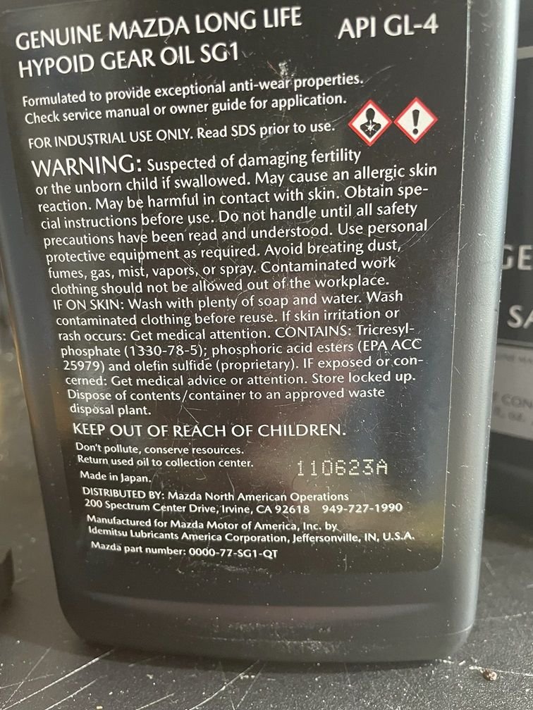

Just an update. I went to the dealership because the washers aren't super easy to get ahold of and are often overpriced. Oddly, the dealership had a better price than anywhere else on the washers AND on the fluid.
The washer part number for fill and drain on both the transfer case and the differential is: 9956-41-800
$2.42 / washer
Fluid part number:
PKSG1 SG1 FLUID 0000-77-SG1-QT LNG LIFE H
$34.44 / qt
Old Feb 20, 2024 | 06:44 PM
Adutchguy's Avatar
Joined: Feb 2024
From: Washington
BTW, the dealership quoted $169.99 each for the Transfer case and Differential fluid change for a grand total of $339.98! Even spending the extra money on the fluid, which I could have probably got away with a cheaper more generic GL-5 or GL-4 fluid, I still save $253.17.
