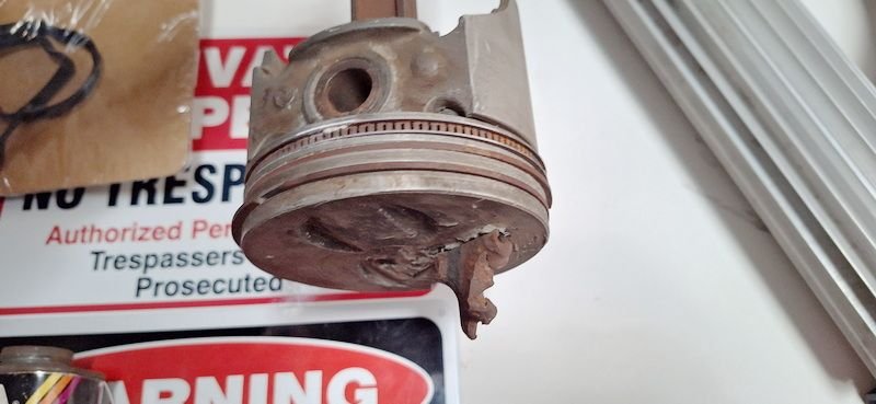

So I was driving on the freeway 2018 CX-5 137k miles, and out of nowhere car wouldn’t accelerate, all sensors went into malfunction mode and engine light flashing. Pushing the gas pedal it just went down and nothing happened. I pulled over and turned off car, wouldn’t turn back on.
Towed it to the Mazda dealer and after a day or two they are telling me that the recommended repair is an engine replacement because the piston and intake valve hit and piston is damaged. They haven’t given me any additional information. See video for damage https://tvidnow.com/nAuh5mP
can you give me some more insight into this? Why would this happen suddenly with no warning signs? Is an engine replacement the only solution to this problem? What are the alternatives?
the car had a recall about the PCM needing reprogramming but seems like it could’ve been connected to this issue, and this repair was supposedly done on my vehicle in 2019.
anywho, any insight is appreciated so I can figure out what to do next. Thank you.

Yup well sorry to see this but unfortunately at your miles it happens and not anything to do with the engine design or ECU commands. The only was to determine the exact cause is a full engine disassembly. The downside it you are out of warranty and a disassembly from any experienced engine builder that can examine "All" the damaged parts (much more than what was superficially found) to determine the exact cause!
I have seen dozen from my own customer's bringing their engine to be rebuild. A piston eating a valve is not as uncommon as many think. LOL
A guess only based on the very limited information is a valve spring or springs broke or on the guessing list and less likely a cam lobe(s) went flat?
