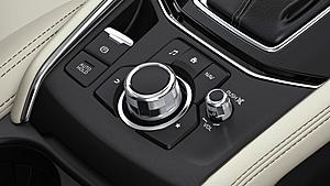

Hi!
I have been searching the internet and haven't found any DIY guides or advice in removing the center command ****(in between the cup holders/shifter) on a 2017 CX-5. I found many guides for the 2016 and earlier models, but the consoles are a bit different with the 2017 model vs the 2013.5-2016 models.
The reason for all this is that I accidentally spilled a container of sauce on some of the buttons on the Command **** and would like to clean it all out. I did my best with cleaning the the buttons from the top, but need to get under the music control buttons/parking brake switch to clean it further.
Can anyone help me with a DIY guide/advice/video on how I would go about removing the Command ****? Any help will be greatly appreciated!
I have attached a photo below of the command **** I am referring to.

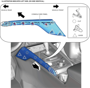

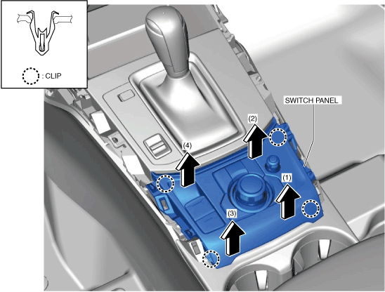

Have a look at these diagrams. No screws or bolts.
Attached Thumbnails 2017 CX-5 Center Command Knob Removal?-side-panel.png   2017 CX-5 Center Command Knob Removal?-comand-switch.png
Perfect - thank you for posting for your feedback and for posting the diagrams! I was able to take off the command **** and the clean all of the buttons to where it's working like before. The whole process took no longer then 30 minutes.
