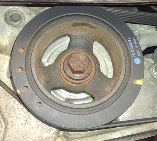

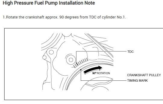

Having the same issue on my 2016 cx5, I am reading this forum and noticing you're saying 90 degrees past TDC, is that 90 degrees in relation to the pulley itself? or 90 degrees in timing? I'm fairly fuzzy on this part the rest I am confident on.
Old Nov 11, 2024 | 07:36 PM
blknblu's Avatar
Joined: Mar 2009
Posts: 18
I am in the process of doing this. The service manual calls for rotation of the crankshaft 90 degrees past TDC.
I did not see any marks (indent, or notch) on the pulley itself except for some paint. I did rotate it to where I thought it should be.
I did not have a chance to see if there is a mark closer to the TDC markings.
With it in its current position, I should be able to see if there is one closer to the inside of the pulley.
I am assuming Mazda wants it rotated for a reason.
