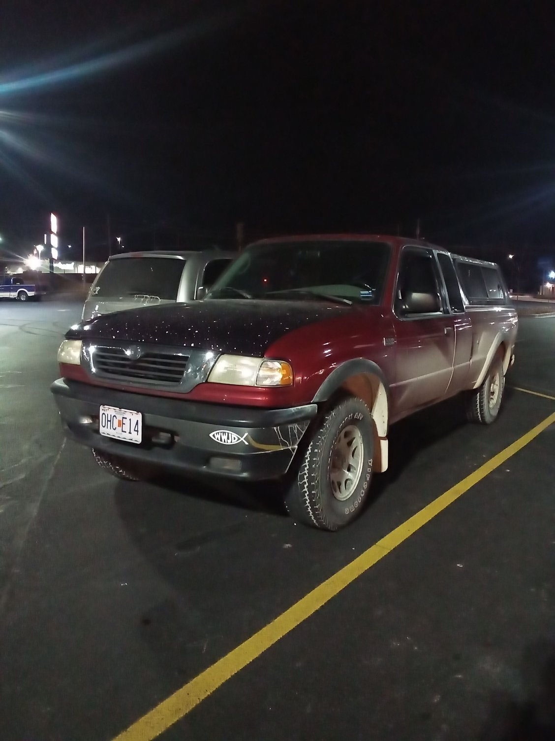

Post Vibration when coming to a stop, only when warmed up, help please
It has new tires now though.
There is no cut in acceleration whatsoever, it has tons of acceleration and very powerful 4 low. It only vibrates when coming to a stop, and only when fully warmed up to operating temperature.
The vibration was twice as bad with the Catalytic Convertor, and I considered it undriveable. I am running without one now.
Odometer reads 260k
