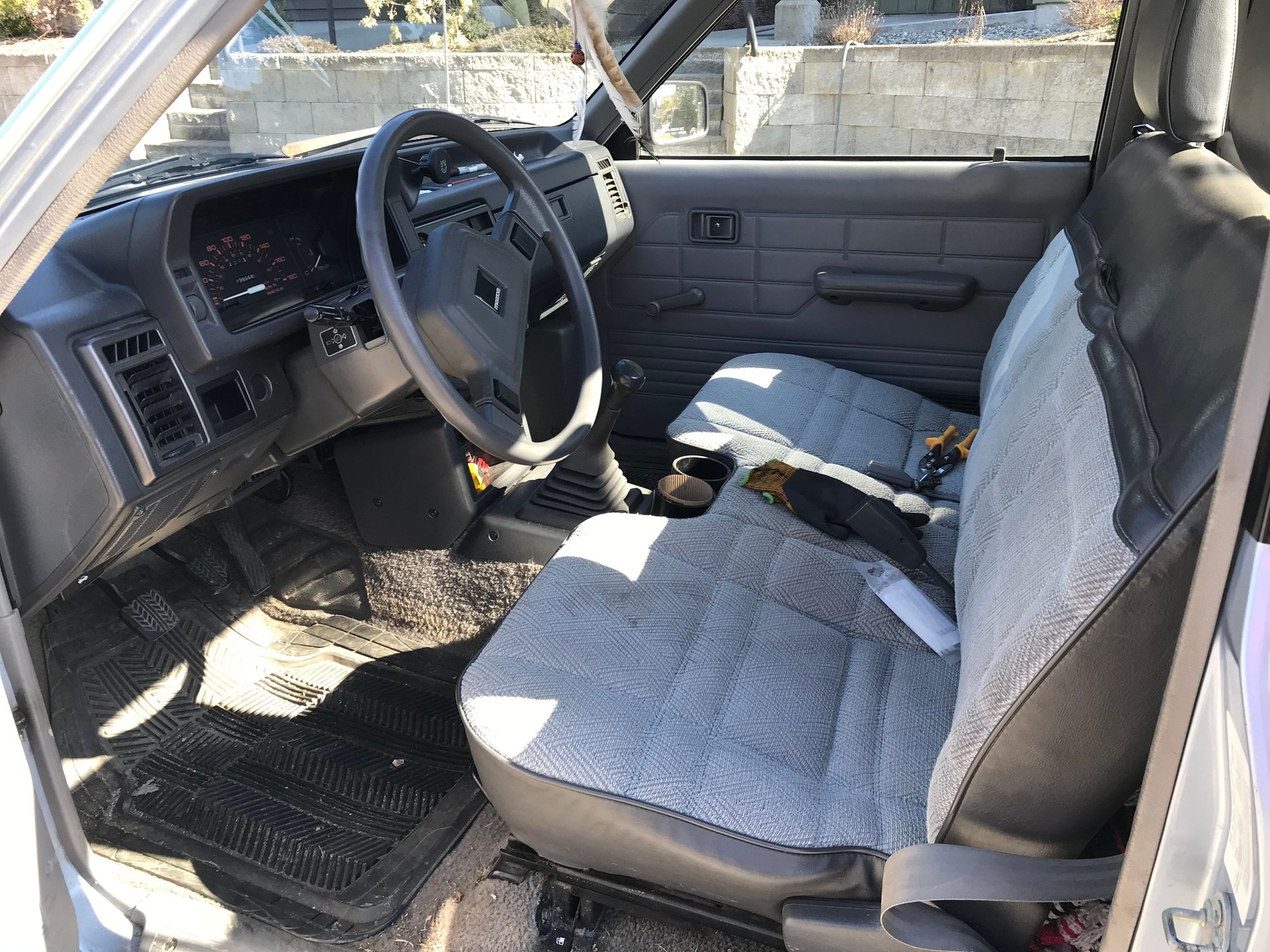

Got this beauty 1.5 years ago. Under 200,000 kms from its original owner. Clearly I didn't take as good care of it as the engine has just been declared dead. Anyone ever had any luck replacing the engine in one of these? I don't know if it's worth putting the money into it as I didn't plan on hanging onto it long term. May just price it accordingly and pass it on to an enthusiast who wants a project. *sigh* so sad.
