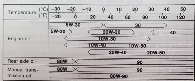

5W-30 may be too thin of an oil for these trucks........unless it never gets above freezing where you are driving the truck.

I'm in Arizona, and I use conventional 10W-40 from Walmart in my '88 B2200. After I change the oil or add 1/2 quart, I do notice some smoke from my exhaust for the first minute, especially the first week after. I'm just used to that now.

Smoke after changing the motor oil is generally caused from a *cylinder glaze or worn out engine.
A cylinder leak down test may reveal which.
Or at least scoping the cylinder will revile often times thing an owner does not want to know. LOL
The viscosity used is a clue to that. An engine in mechanical sound order having to do with the cylinders is directly influenced by viscosity of the oil.
