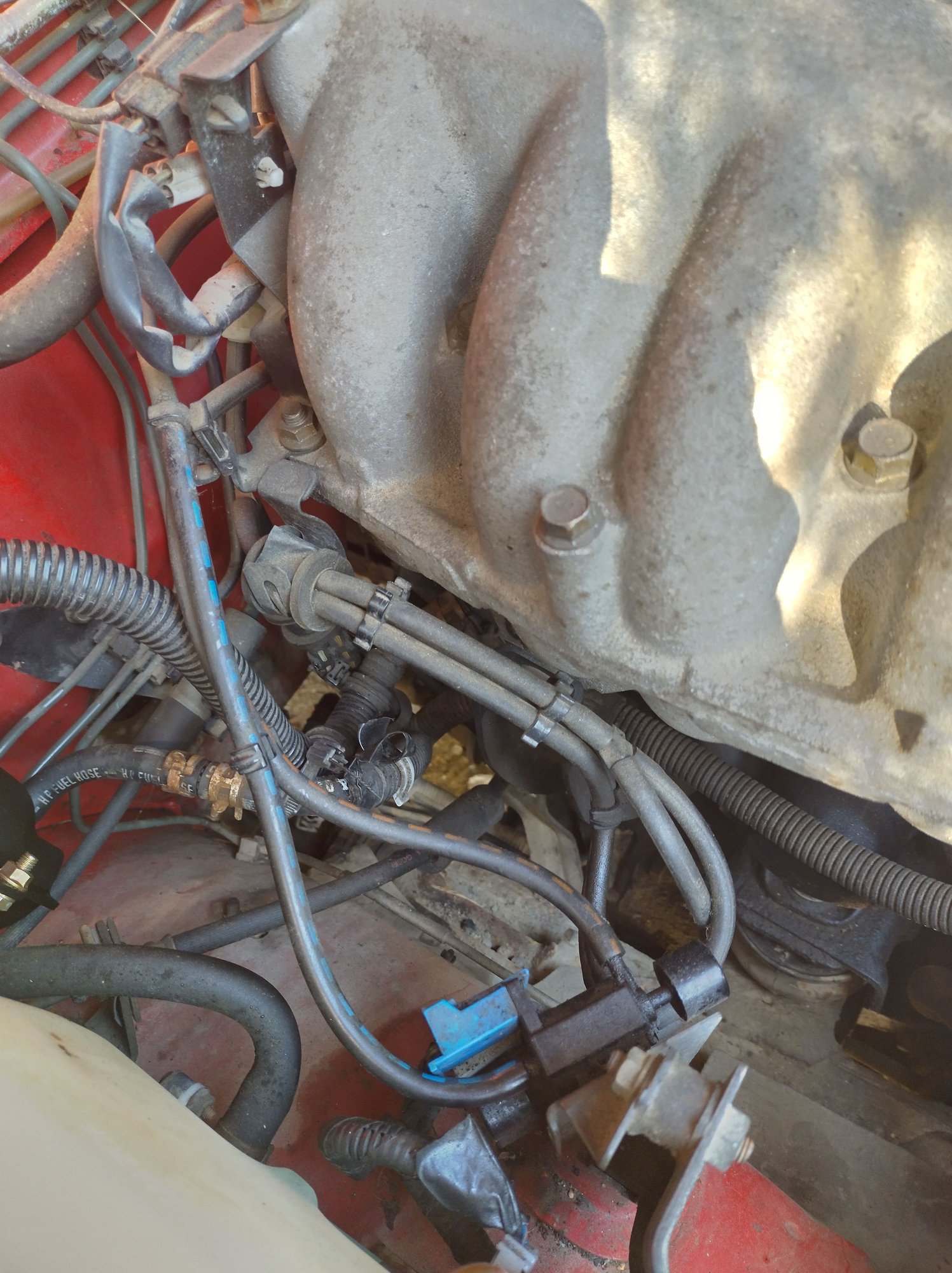

Just checking to make sure that you do have the rubber air tube in place, and the black plastic "Pulsation Chamber" in place with a tight fitting O-Ring on it as it should.
If there are ANY air leaks in the intake system, then the engine may not run very long at all (2 seconds maybe) and then die. Can you post any pictures of the engine as it is now?
Old Aug 8, 2024 | 03:02 AM
samp49's Avatar
Joined: Aug 2024
Posts: 6
From: Finland
Default Some pictures
About the problematic motor I am wrestling with.
