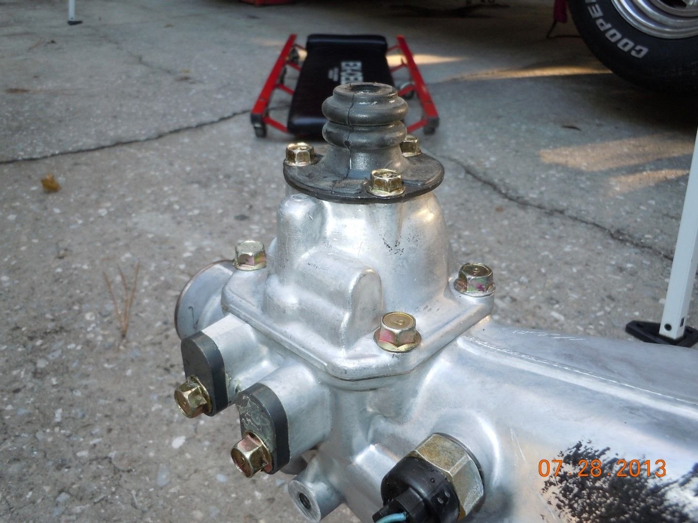

You mean this pin.....at the 7 o'clock position in the picture?
If so, you can actually remove that part of the transmission shifter housing, make a gasket, and bolt a different one on the trans that has a good pin......or remove the part of the housing to better access it in order to replace the broken pin in your housing.
