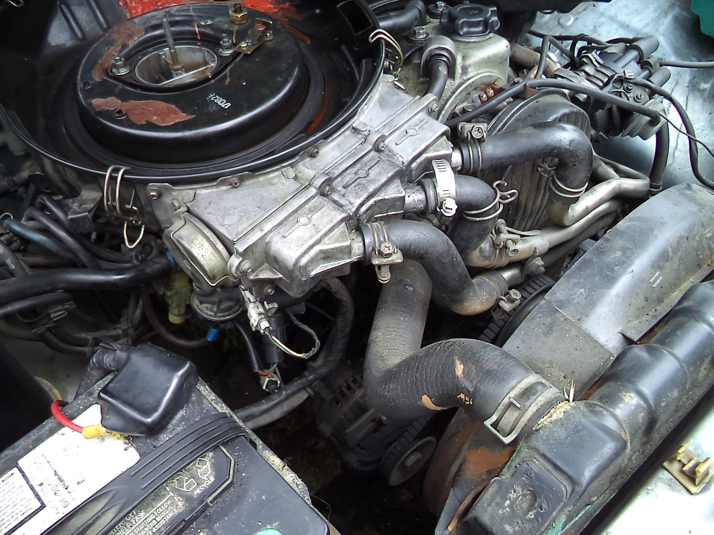

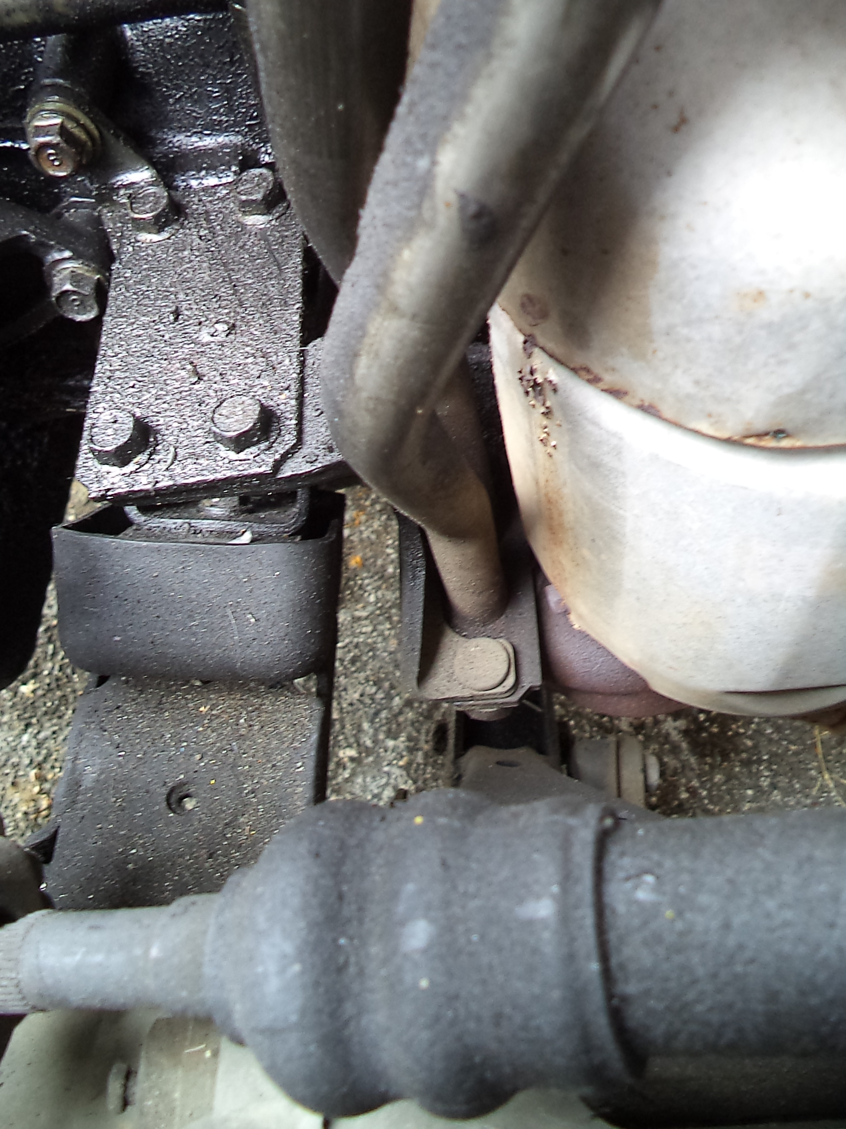

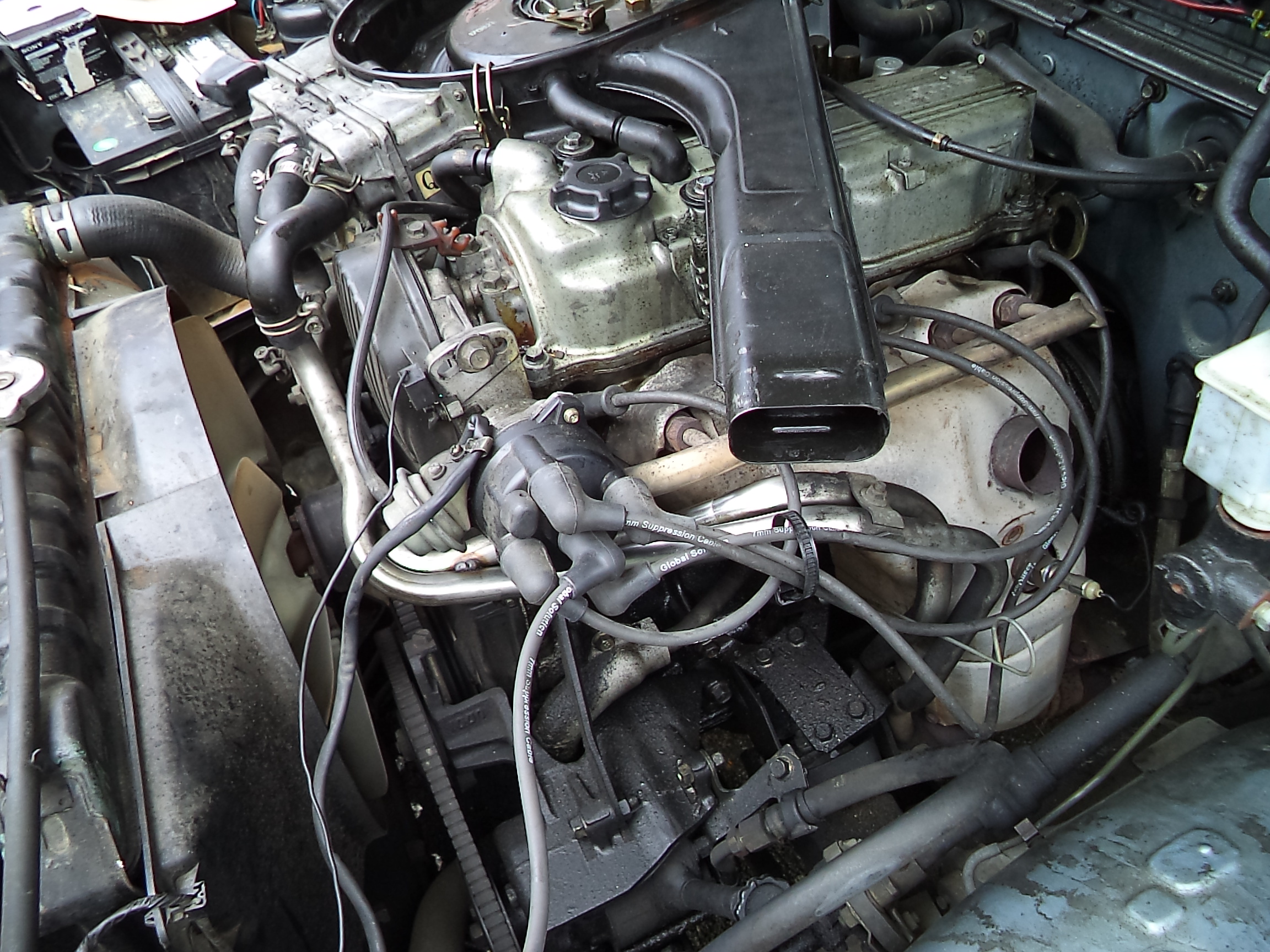

Pics of the plenum with the 3 reed valves, plumbing running down to the primary cat/vert. Attachment point.
Can this all be discarded and blanked off.

If your truck is not in Maricopa or Pima county, no emissions tests. I have this on my '88 B2200. You can plug the three rubber hoses with rubber stoppers from Ace Hardware, or just remove them, which I later did.
I made a steel block off plate and slid that in and bolted it down where the twin tubes bolt on. I use capped lug nuts ($6 pack of four) to seal off the four ports on the exhaust.
