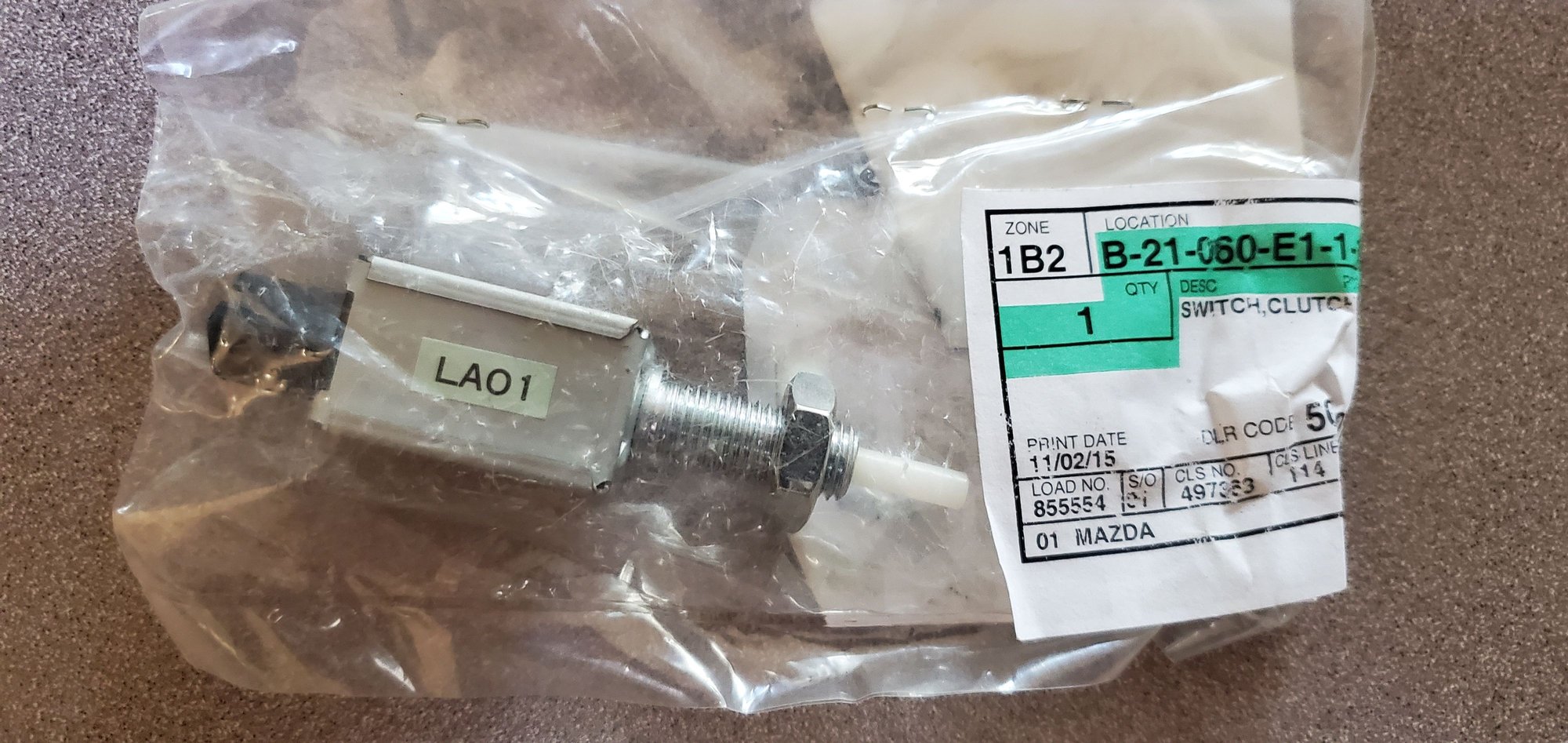

I encourage you to remove your Clutch Switch and open it up! If the plunger is broken, or the small spring inside of it is broken.......it ain't working!!
Clutch Switch looks like this:
