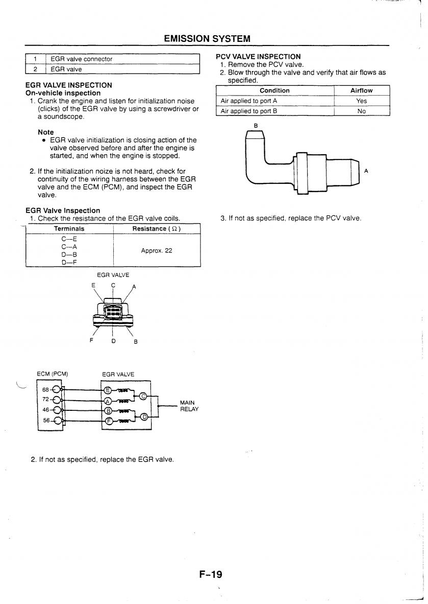

Attached picture is from workshop manual for 626 97 (GF) 4 cyl Euro

Thanks. I found it. Is there anyway to check this before I replace it?

See this
