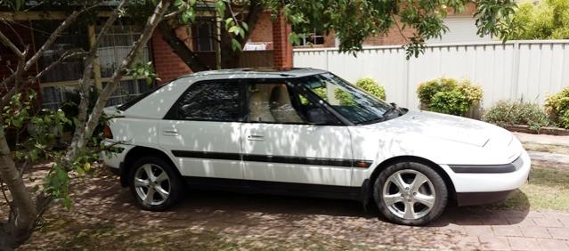

Thank you I will try a few of theses ideas. This is my car,by the way I am female
Attached Thumbnails 323 Just clicks when I try to start it when hot-20131223_141656.jpg
