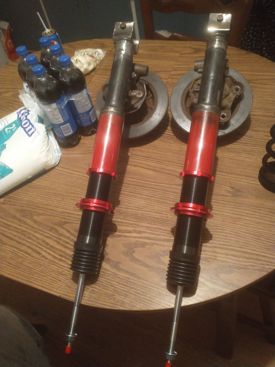

These are a set of coilovers I've started building for my 84 glc, couldn't find anything so I got creative and built my own
Test fit on front spindle.

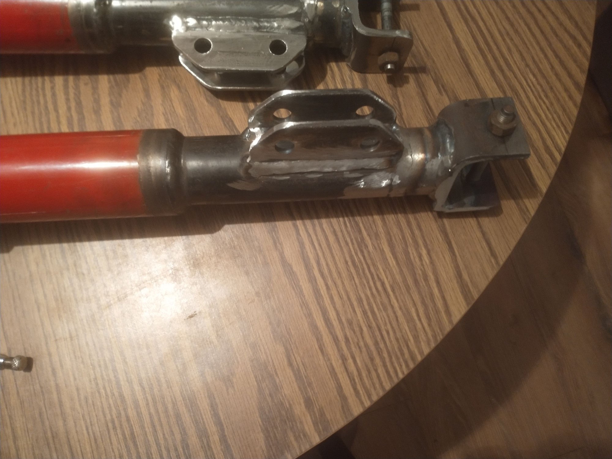

Rear coilovers
We all know how long the rear struts are so I had to add some length to this existing sleeve on the coilovers.

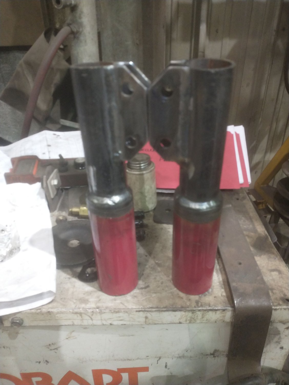

And these are them assembled minus top plates which are at the machine shop.

Long pair are the rear coilovers, complete with lengthened sleeves and mounting point for trailing arm.
Custom made rear top plates for the glc.
Front top plates machined with slots for camber adjustment.
Better view of the rear setup.
