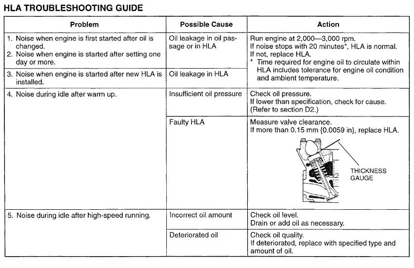

that translates into a little over 65,000 miles. not bad for a '96. => That's a dual overhead cam engine you have. If I'm not mistaken, you can reset valve clearance by replacing the tappets (Mazda calls them "HLA"--head lash adjusters?) on top of the valves. is that what you're referring to?
before you replace them however, check the clearance between each tappet and cam lobe with feeler gauges, with the valve completely closed (cam lobe pointing 180 degrees away from the valve) . I've attached an image of the troubleshooting guide that covers the extent of the noise you get from these, when to replace them, and the clearance spec for them.
Click the thumbnail, and then on the large version of the image, right click and choose the option to save the image. Good luck!
