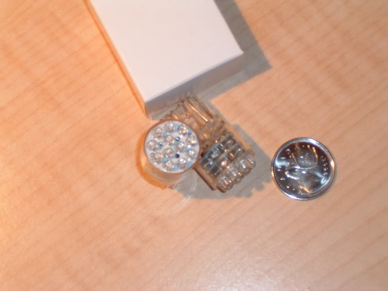

Im all done! wasnt bad bad at all...took me maybe 25min. I did not have to remove that plastic molding, just careful bend the carpet. Removed the 2 nuts and out she came.
Thanks for all your help guys.
If anyone is wondering why I was fumbling around on a brand new tail light. I replaced the factory incandecent amber turning light with aclearbulb, that when ON, shines amber. Now the whole tail light is clear and white. Looks good!
