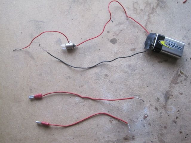

The alarm on my 2010 Mazda3 sounded several times for no apparent reason, usually at night. My friendly Mazda dealer checked the log which found the alarm had been triggered by the left front door being open – which it wasn’t. The door status switch within the latch mechanism was obviously giving a false Door Open signal. These switches, one in each door latch, are responsible for setting the alarm and also allowing remote locking to operate.
Removed the door trim and checked the switch with a multimeter – open door, the switch was open. Closed door, the switch contacts should be closed with zero resistance, but there was a reading of more than 100 ohms – high enough to look like an open switch. The latch mechanism can’t be stripped to clean the contacts, and a new latch assembly is £150!
I fixed it for nothing – here’s how. Remove the door trim, disconnect the white connector near the latch. Fit wires with small connectors to the switch terminals – on my car these are the two outer pins in a group of three larger pins, may be different on other models. This is the tricky bit, you need connectors small enough to fit on the pins without touching each other. Use a multimeter on Ohms range to check the switch action – should be open circuit/infinity with the door open, and zero ohms or close to it with the door closed. You can operate the door catch with a screwdriver shaft or similar.
The reason for any high resistance present is oxidisation of the contacts, which will build up over time (my car is 12 years old). Oxide does not conduct electricity very well. This is not normally a problem in most circuits as the oxide film will be broken down if the switching current is more than about 10 milliamps – this is known as the “Wetting current”. However, the door switch contacts feed into a microprocessor and the current is tiny, about 3 milliamps.
To fix it, make up a simple circuit with a 9 volt PP3 battery in series with a small 12 volt bulb such as a number plate lamp bulb. Connect this to the two test wires you fitted to the latch terminals so that the bulb goes on and off as you operate the door latch. Repeat ten times. This will pass around 600 milliamps through the contacts and break down the oxide film. Recheck the switch function with the multimeter and you should now have zero resistance with the latch closed.
I did this a year ago and problem solved, no more false alarm triggering. Yesterday the remote locking would not work. I checked the driver’s side front door latch switch and found the contact resistance with the latch closed was over 1000 ohms. Did the procedure as above, all OK now and another £150 saved!
