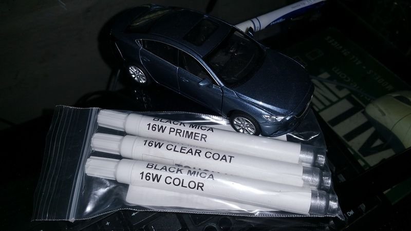

For many chips up and even some scratches this kit if you follow the direction to the letter result in nearly impossible to see the paint repair.
Notice it comes with Primer, Factory paint and Clear coat to seal it up!
You can wax or polish it after it dries in a day and not ever worry about it coming out from washing your car.

Ya those touch up pins and paint dating from forever back will not fill the chips.
The little 3 step set sets I use seems to work very well.
Touch Up Store (amazon) 1(704) 616-1675
