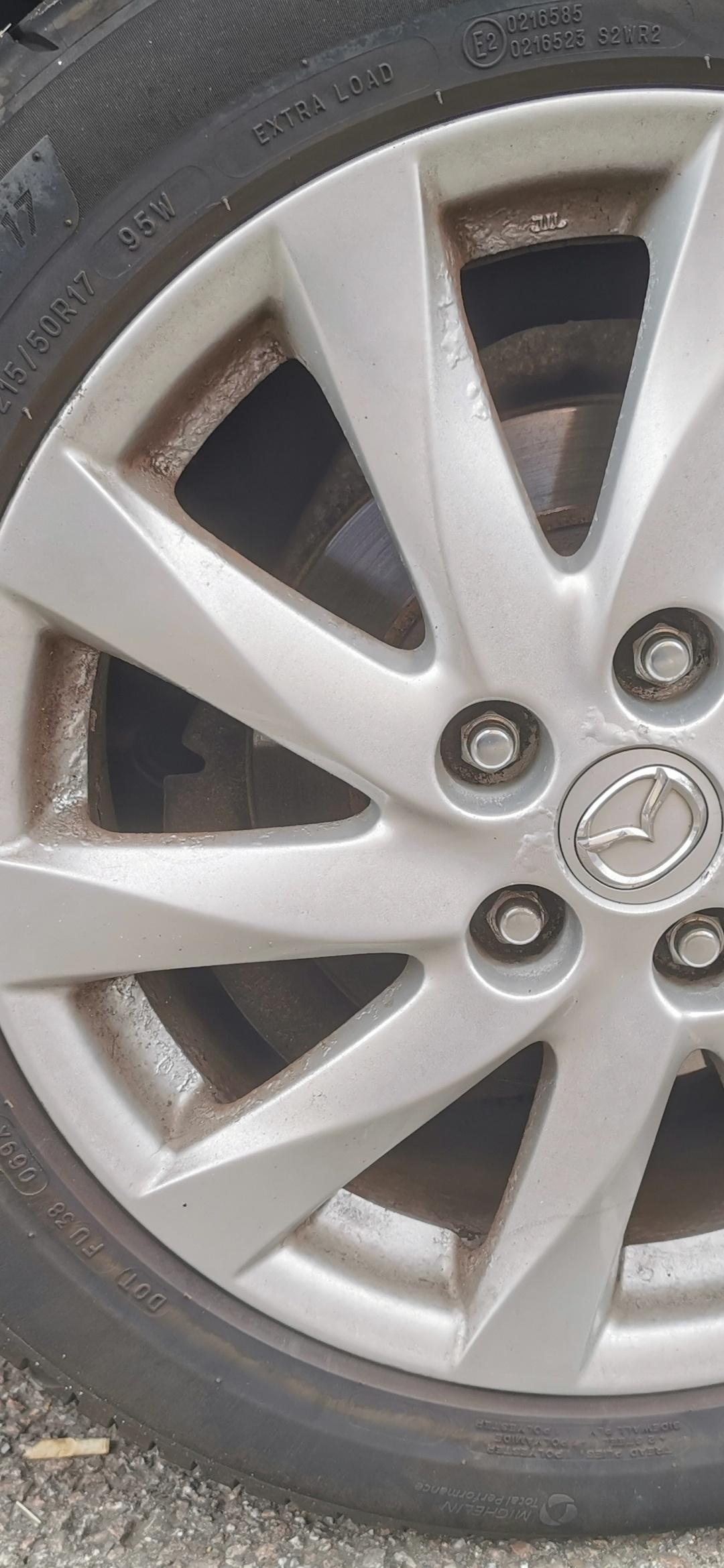

Hi guys,
As you see in the picture, my rims have bubbled up (to be more precise I have bought the car like this). Now I could get it redone with a rim refurbishing service, however I would prefer to do it myself. But I am quite clueless as to what exactly would I need.
I have 5 rims that I need to do. I have already asked some people. But I have been told that most spray paints are soft for using it on rims, and have recommended me to use 2K paint, nitro paint or even powder coat it.
As far as I've been told I would need to soak the rims in paint stripper and then wrap them in aluminium foil, leave it for a while then wash the paint down. I was also told I can use vinegar to get rid of the oxidization of that is the bubbling. And then I would get my standard deal of filler, primer, paint and then clear coat.
Would just removing the bubbling, sanding it down and then doing the rest of the steps be good enough? I am just worried that I would do a bad job and the results would not be anywhere close to what they should look like. Because if it is quite technical to have it anywhere close to a decent standard, then I would just opt for the refurbishing service. But if I can save a few, learn something new and have good rims come out of it, I would rather do that.

Hey mate, if you know what you are doing you can do it but thread carefully, Before starting, thoroughly inspect the rims to identify the extent of the damage. If the bubbling is only on the surface and hasn't affected the structural integrity of the rims, you may be able to refinish themStart by removing the wheels from the car and cleaning them thoroughly to remove any dirt, grime, and loose paint. If you plan to strip the existing paint, you can use a paint stripper. Be sure to follow safety precautions when working with chemicals. If you opt to remove the existing paint, follow the instructions on the paint stripper you use. Soaking the rims and then carefully removing the old paint with a scraper or wire brush can be effective. If the bubbling is due to oxidation or corrosion, you might need to sand down the affected areas to smooth them out. Apply a filler if there are significant imperfections, and sand it smooth. Apply an automotive primer to the rims to create a smooth and even surface for the paint to adhere to. Make sure to use a high-quality automotive primer designed for this purpose. Choose a high-quality automotive paint suitable for rims. 2K paint or powder coating is recommended for durability and a professional finish. Apply the paint in even coats, After the paint has dried, apply a clear coat to protect the finish and provide a glossy appearance. Clear coat also adds an extra layer of protection against environmental factors. Allow the paint and clear coat to cure completely according to the product's instructions. This usually involves a drying period of several days.

Having painted a few dozen wheels with rattle canned paints including a MAZDA wheel that needed damage repair.
Easy DIY curb damage wheel repair - Mazda Forum - Mazda Enthusiast Forums
'Its not as complicated as the last post!
A DIY should remove the tires and have the wheels sand blasted. If there are any large chips use JB Weld NOT filler and sand smooth.
There are many * rattle can paint for wheels and are extremely durable. Epoxy paints and powder coating are not as strong as people always seem to think and getting wheels done is not cheap.
I am sure you can DIY all 4 wheels for under 200 USD and they will look great!
BTW your picture indicates that you may have gotten into some road chemical that reacted to the paint which is also another reason why to have the wheel sand blasted.
VHT Wheel Paint -- High Heat Coatings (vhtpaint.com)
