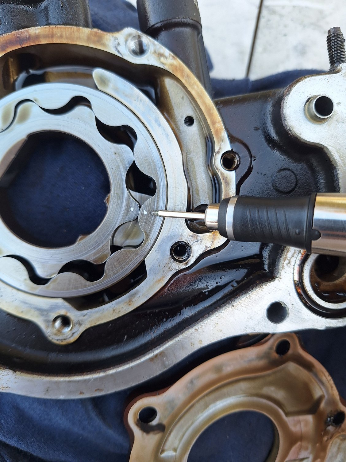

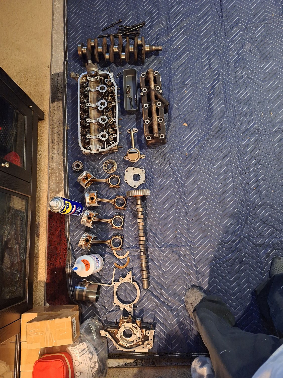

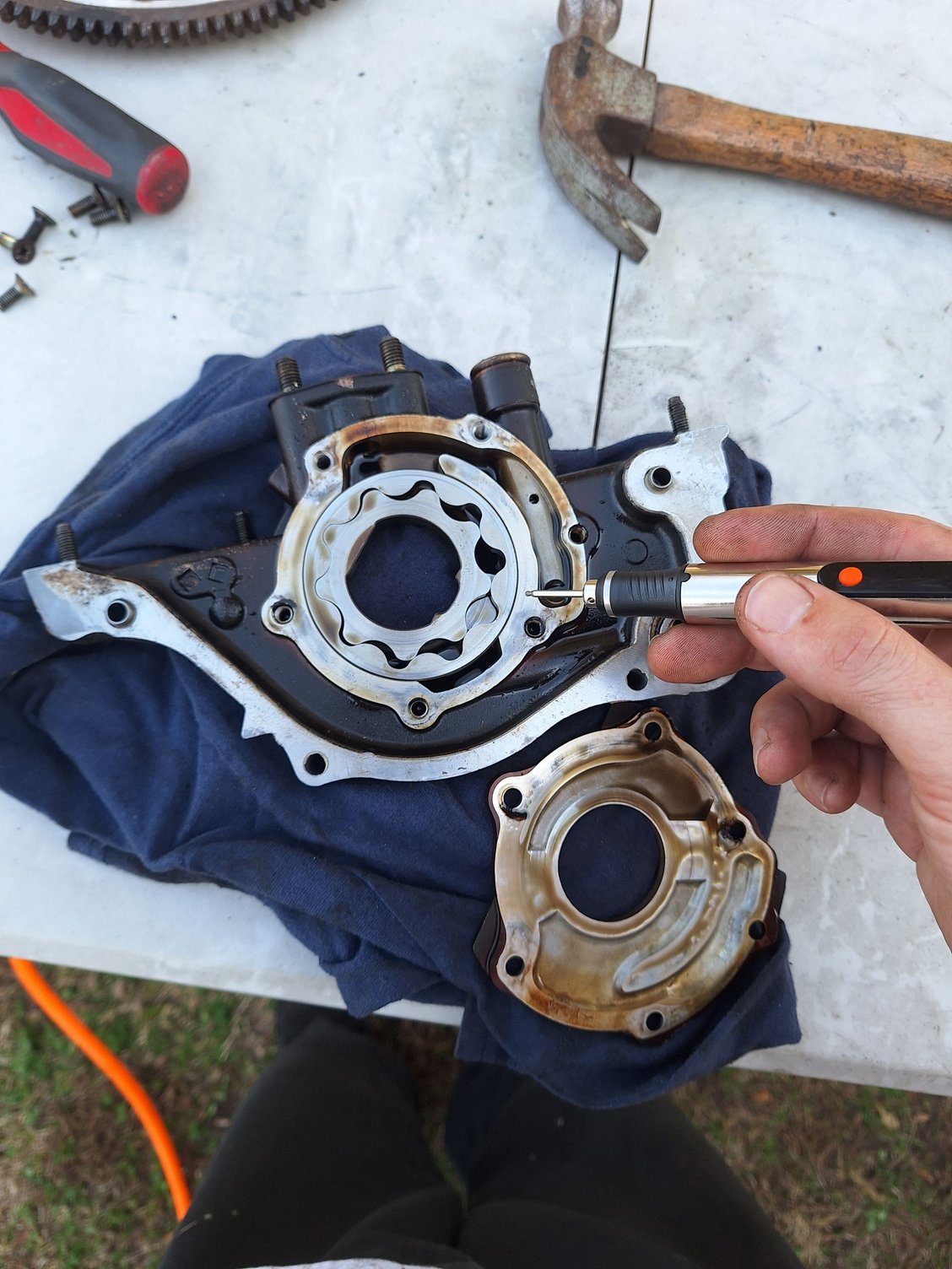

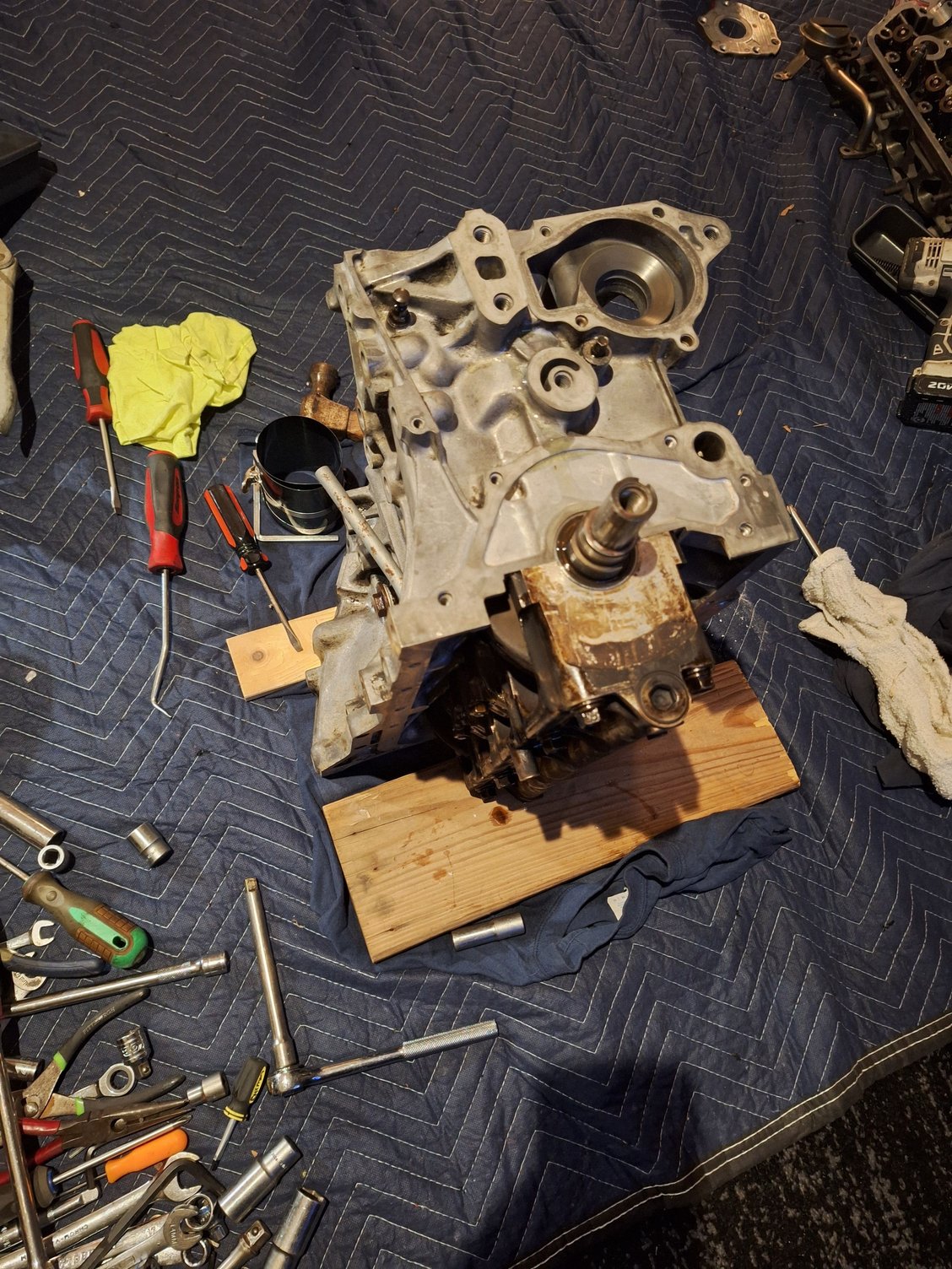

Man, these little pump fasteners are tough! I wound up cutting my own Phillips tip for the impact driver to fit the screws. Its all cleaned up now, but I am debating shimming it a little before I pack it and reassemble it.

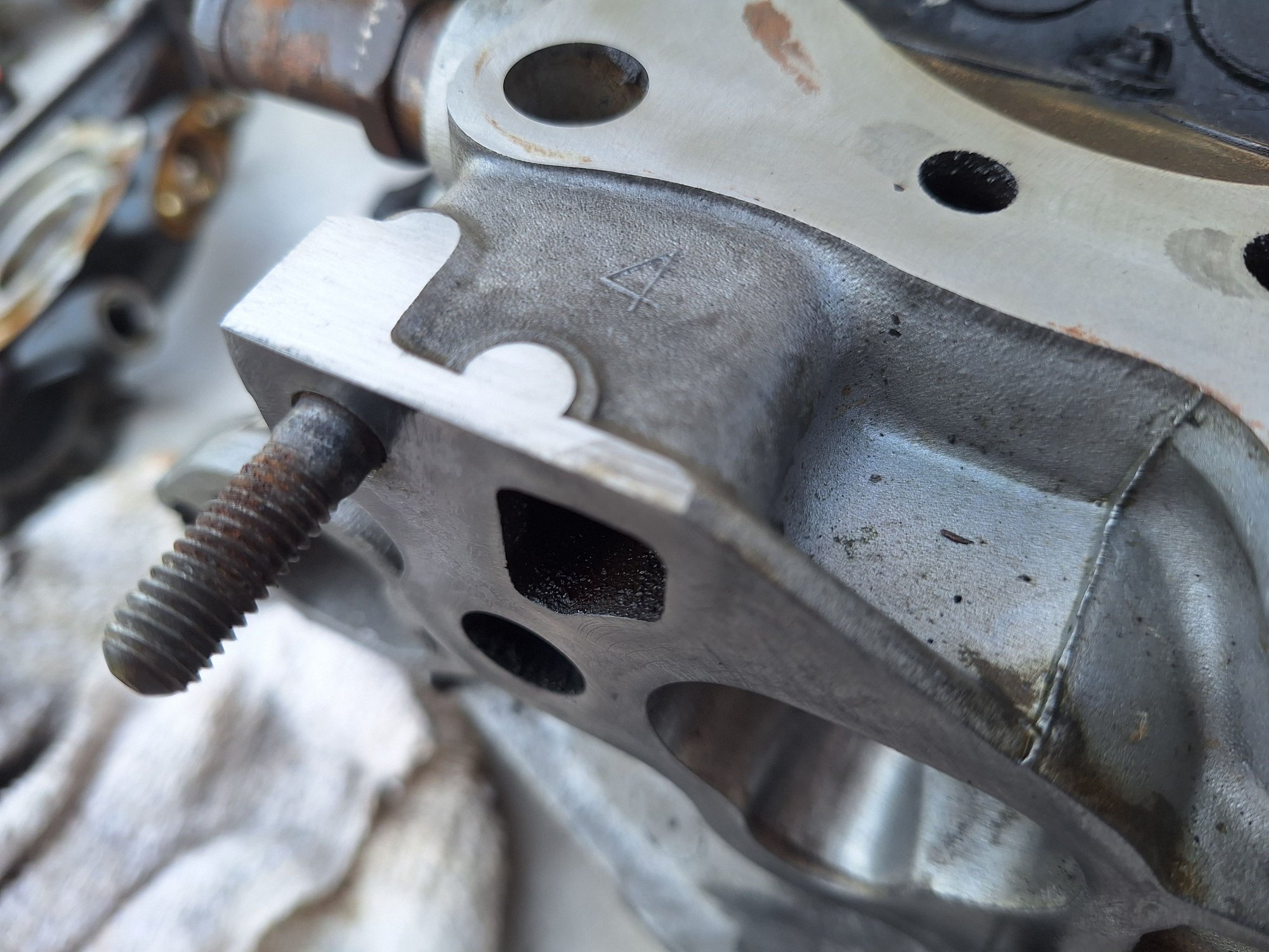

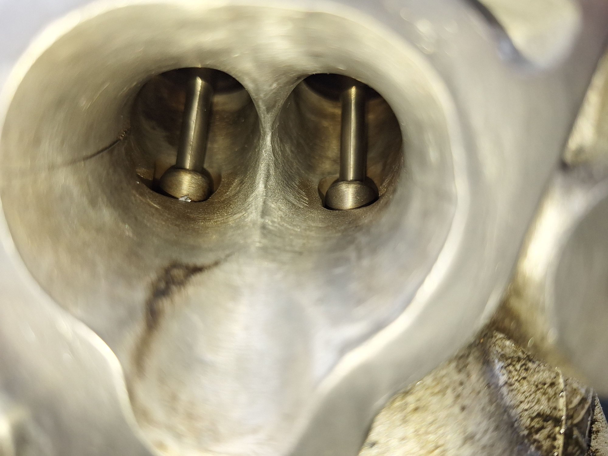

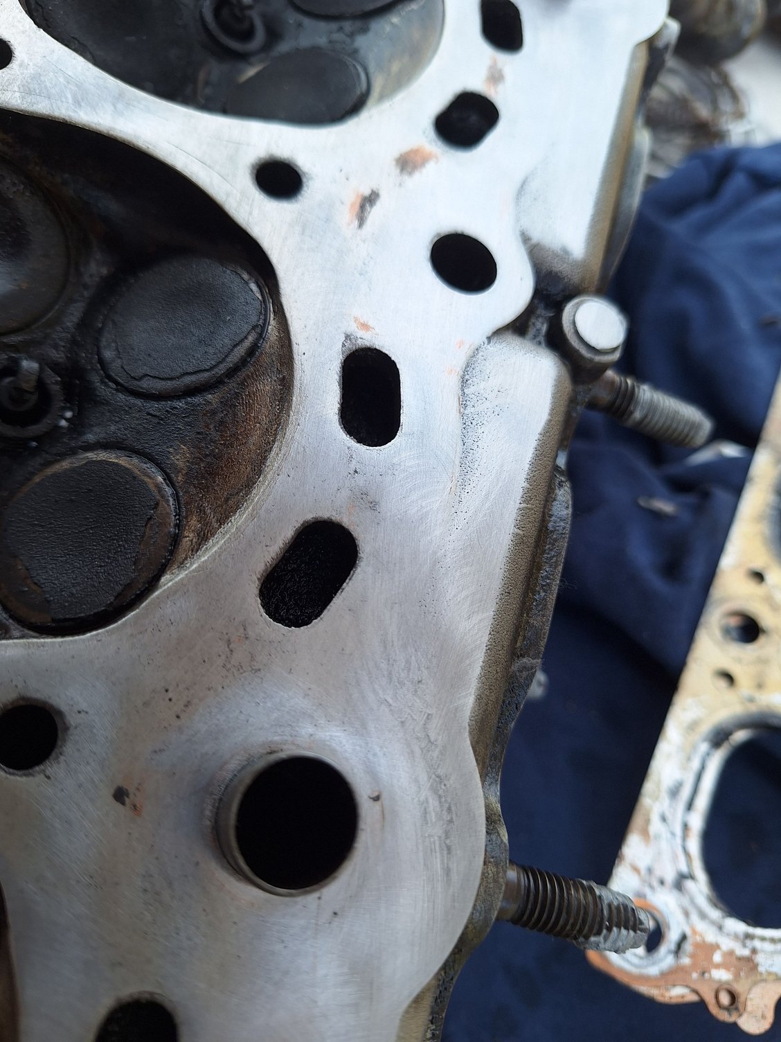

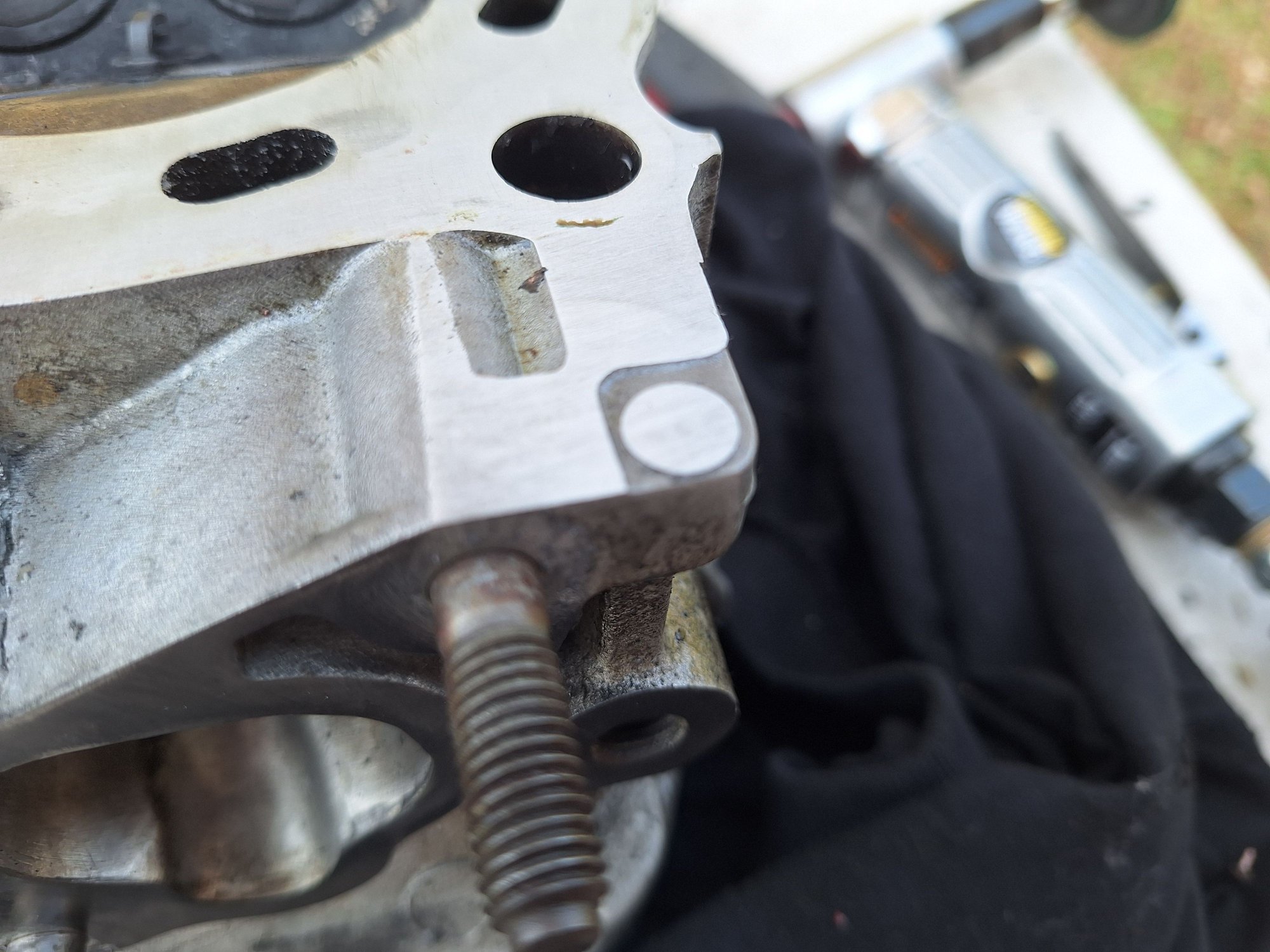

Here is the oil burner head from Little Red. A few pics of the casting limiter posts. Ground down to nothing. Heavily milled previously.
No laughing! About 13 years ago, this was my port work. Pretty terrible, but the casting is still running. Oh well!!!

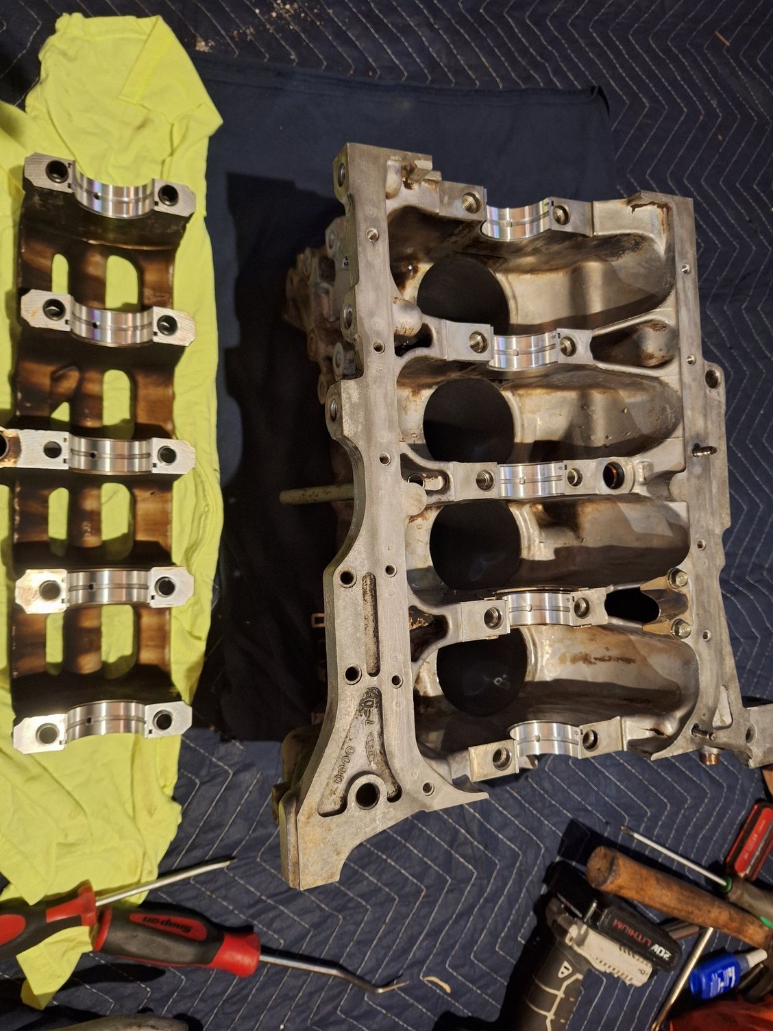

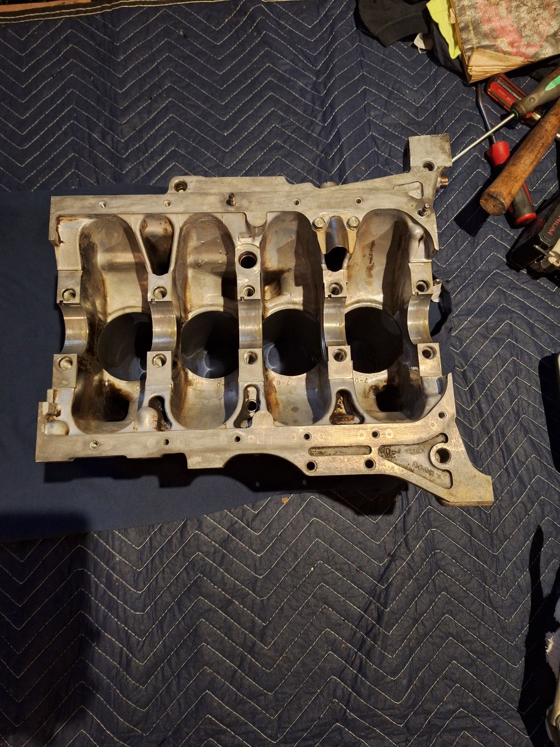

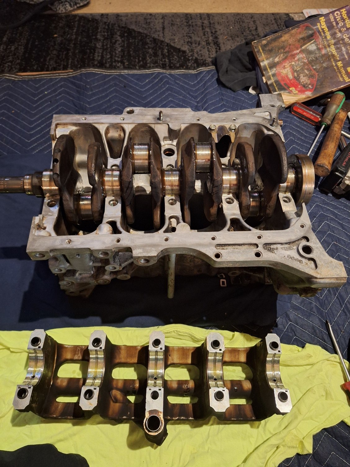

All Cleaned up and moved inside. 😉
Rotating assembly is assembled. Now back to that oil pump...

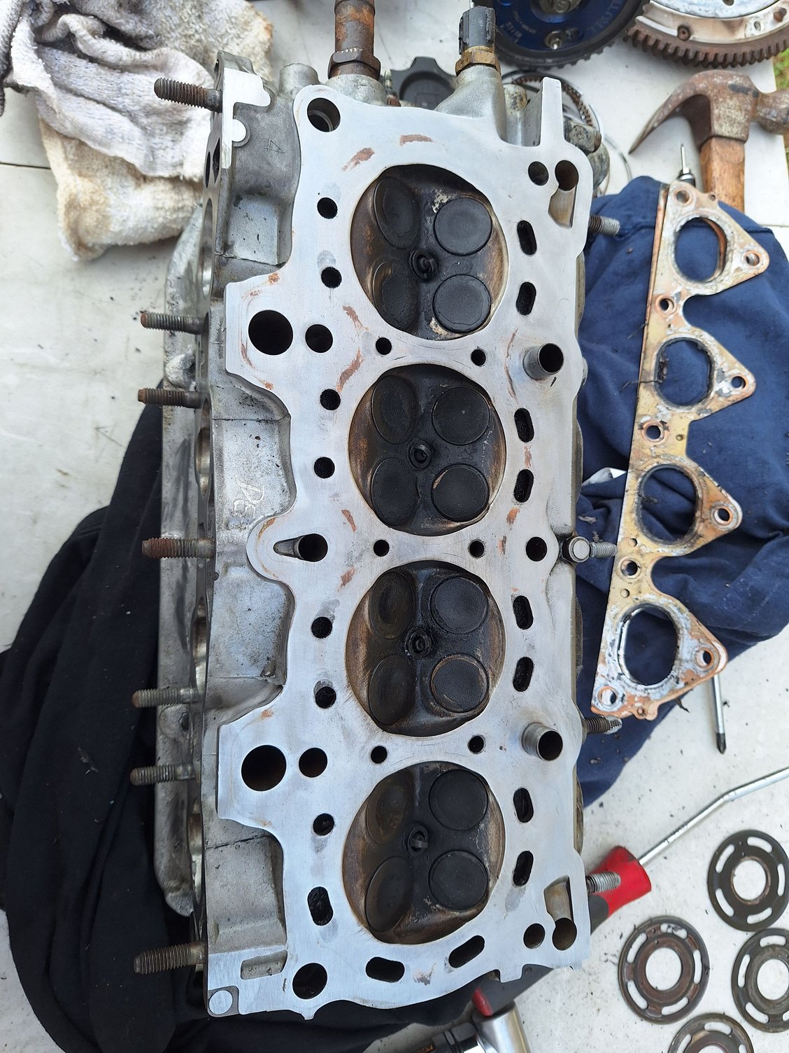

Also found the smoking issues... every damn valve stem seal walked up the stem. 16 valves of oil dump. I have no idea what happened. I remember smacking them down lightly upon the last assembly. I suppose I got some improperly sized parts, before.
