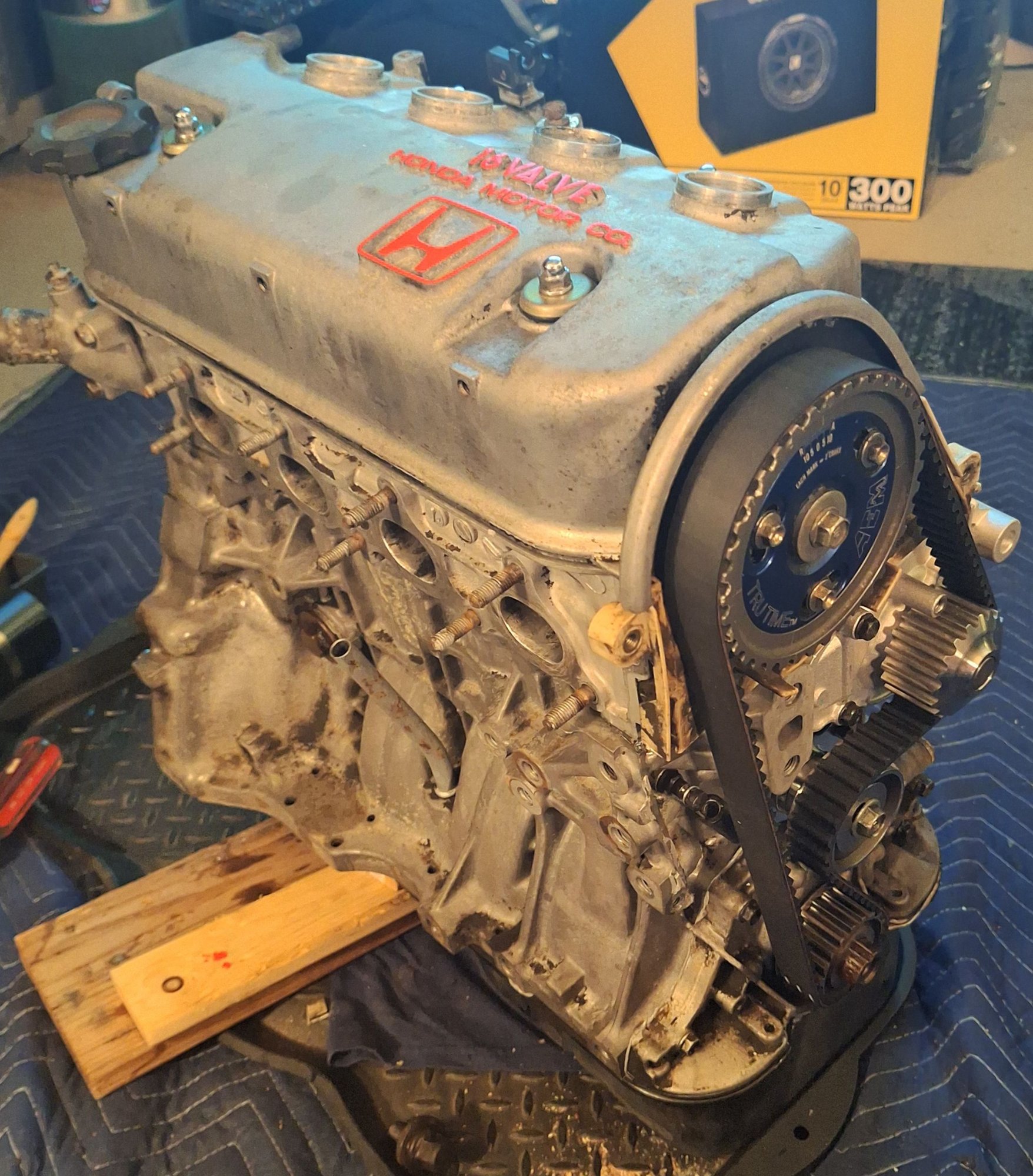

1. The biggest problem is I have an adjustable camshaft gear, and the head is milled about 55 thousandths. This makes the cam timing seem a half a tooth off. Forcing me to set it up and correct it with the gear adjustment. I chose to set it retarded visually. Because of this ignition timing is out the windows.

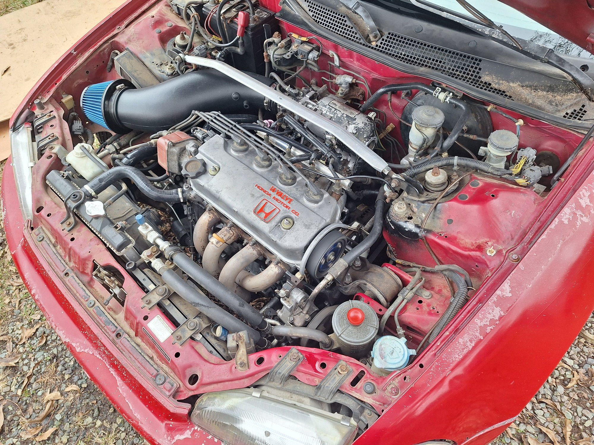

Little Red rides in-tint is running great and driving, today. Just a few loose ends like: Making a catch can, tucking the ecu back inside, and a good cleaning all over. I also have a strut set and some engine mounts, but that will come in time. No rush.
Back on the road... but it took 2 weeks. 😆
