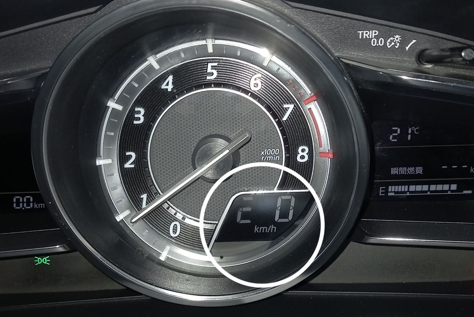

have digital speedo that shows a digital speed that does not correspond with the hud display.Has anyone had a similar problem and can suggest a solution? Vehicle is a Mazda Axela 20s 2014

Its not the speed difference its the actual reading itself.

First you've said the speedometer doesn't correspond to the speed shown in the HUD, now you write, there's no difference, it's the actual reading.
Do you mean the missing or not working LCD segments?
That is a very common issue, failure of IC PT6522LQ or PT6522-Q, both are used by the manufacturer. They are the same chip but their bodies / packaging are different. There's no way to find out beforehand which one you got until you have the instrument cluster open. Search Aliexpress, Ebay etc for the part and find an electronics specialist to replace it.

Sorry about that. Yes the its the "missing or not working segment"' that's my issue. You can see from my photo that is says '2 0'km and that's when its parked!!!
Thanks for the help! I appreciate the help it! I've noted down the numbers you've mentioned and I'll look into it.

A quick IP search shows you somewhere near Kekerengu, South Island East Coast, Aotearoa.
Contact Robinson Instruments regarding a possible re-build/ repair. https://www.robinsoninstruments.co.nz/
