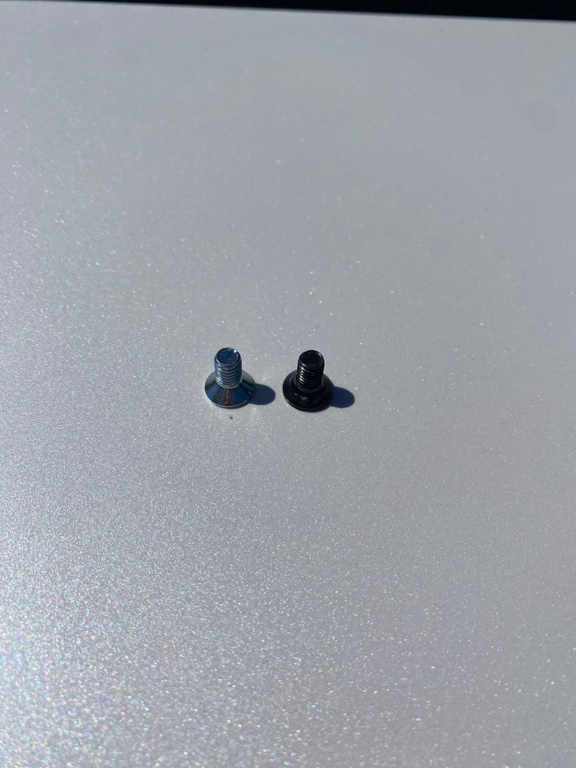

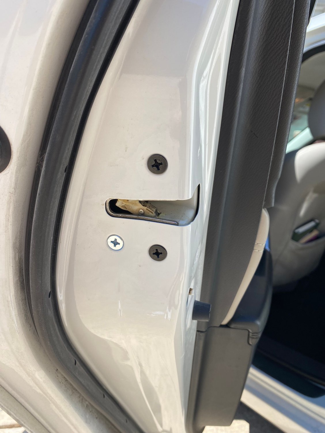

If any of you have had an issue with the screws coming loose and missing on your door latch mechanism and are wondering what size they are, they are M6-1.0 x 12 mm. The original Mazda part is 9YA500602.
These are the short black philips head countersink screws that hold the latch to the door frame (photos attached). I have a 2016 Mazda 6, but these may be used on other models
I bought a 3 pack at Home Depot for $2.75. Just put some blue Loc-tite thread lock on them before attaching to prevent them from working loose. The OEM screws have a washer attached that I guess is supposed to be a lock washer. Although, it didn't work very well.

Good thread.
We just re-torque them in the shop. The looseness comes for shutting the door harder then it really needs to be.
However for DIY its easy fix if you go the fastener replacement route . I suggest checking all of them but it is mostly the drivers door that get effected?.
Plus another advise is when exiting slow down and make sure the belt latch is not in the door jam area.
99% of owners eventually have nicks of paint their.
