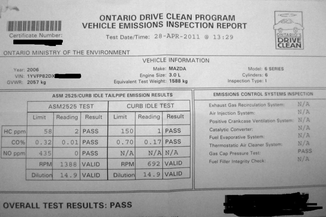

Found some new info: How to Fix Emissions Problems On a Car | eHow.com (first item is clogged air filter).
Copied and pasted this from: My car failed an emissions test. Now what? — Yahoo! Autos
The best way to improve the odds of passing an emissions test is to maintain your vehicle. A well-maintained engine is usually a clean engine as far as emissions are concerned.
Changing the spark plugs, air filter, fuel filter, PCV valve and oil regularly (or just before an emissions test), checking ignition timing and adjusting the carburetor (if you have an older vehicle) can reduce emissions and greatly improve your chance of passing.
Also, filling up your fuel tank with gasoline that contains 10% ethanol alcohol (many premium grade fuels use alcohol as an octane booster) may help lower your emissions even more. Many areas now have "reformulated" gasoline that contains alcohol or MBTE that adds oxygen to the fuel to reduce carbon monoxide and hydrocarbon emissions.
Just before the test, make sure your vehicle is at normal operating temperature. Take it out for a short spin down the expressway. This will heat up the oxygen sensor and catalytic converter to minimize emissions.
OTHER TIPS: 1) Clean Oil burns cleaner than dirty oil. Yes you should change your oil before an E-test, especially if your car is using oil. Change PCV.
2) Do not turn your car off when you reach the E-test place, leave it running. Tell the person to get you in your vehicle while you wait, revving it up to 2,000 rpm occasionally (the EGR does not work @ idle, they actually test it around 1500 rpm).
I have attached my E-Test after having the car for 5 years.
Attached Thumbnails catalytic converters not ready-e-test_cropped-enlarged.jpg
Last edited by UseYourNoggin; Jan 20, 2012 at 11:46 AM. Reason: Updated Clearer Pic of E-Test
