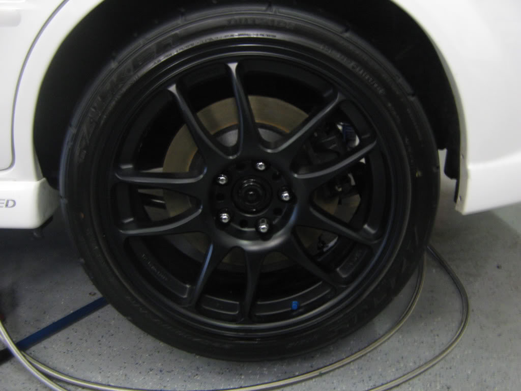

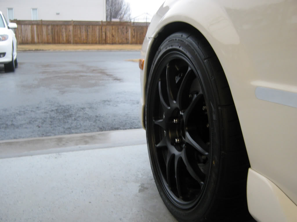

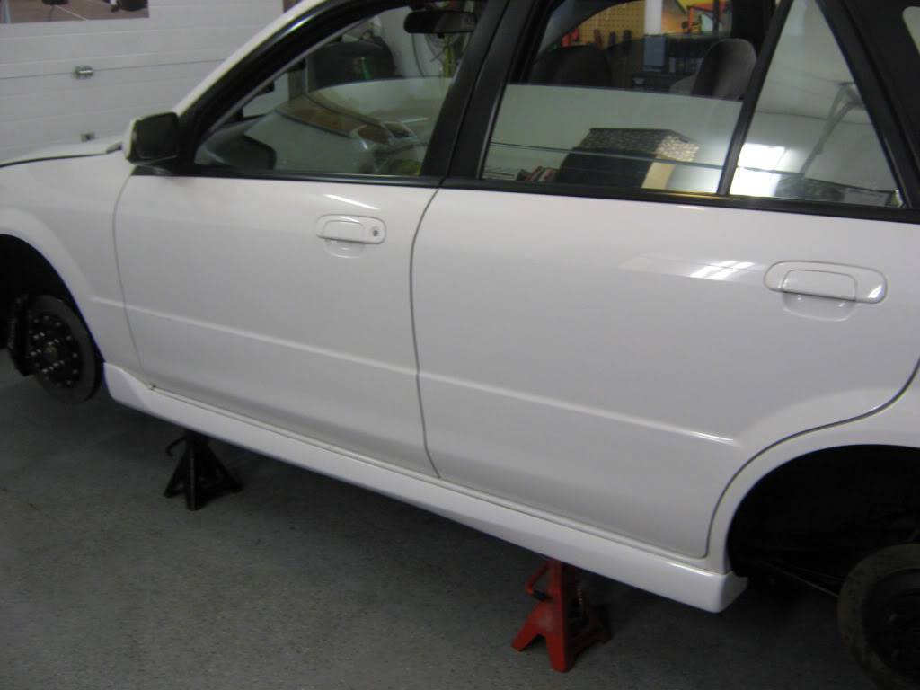

New Rims from my Trip to Toronto. They are WORK Emotion KAI, in a non standard Finish, Semi Gloss Black. They are about 9 Pounds lighter (Each) than the other rims, and the tires are 3 Cm Wider than Standard. Big thanks go to Scott (TO Protege). They need to be rebalanced with the weights in a different location, there is 4mm-6mm of clearance from the caliper to the Rim. LOL The weights will not pass between.
Before Anyone Comments on the Height of the Car. I am letting the car Settle and then will play with the Height settings a bit on Tuesday. These tires are only 1cm Wider, but that 1cm is HUGE.

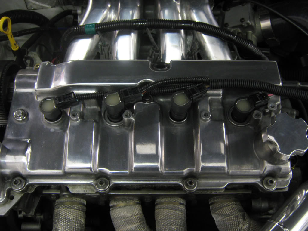

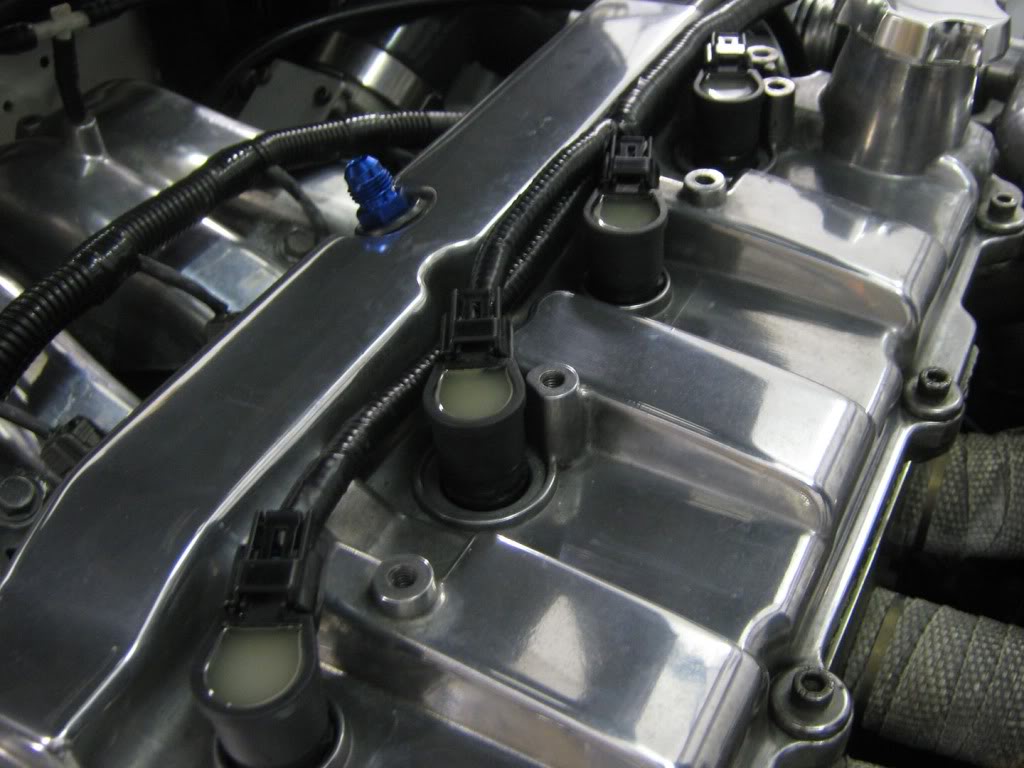

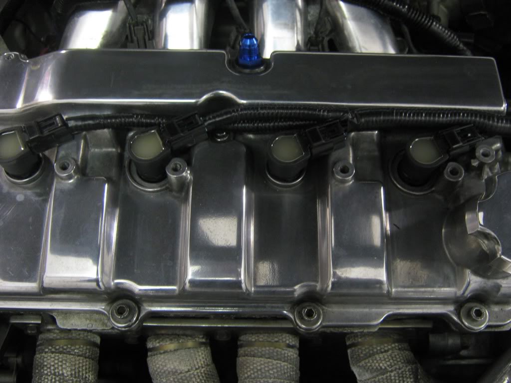

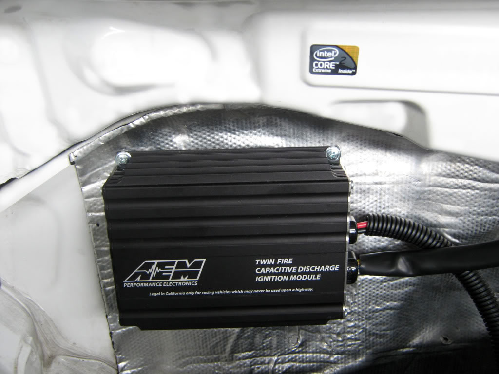

Installed the AEM Ignition Box. Now that this is located, I can start to wire in the Coils.

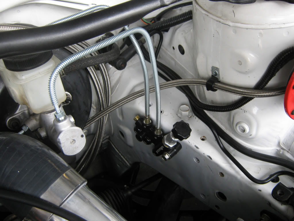

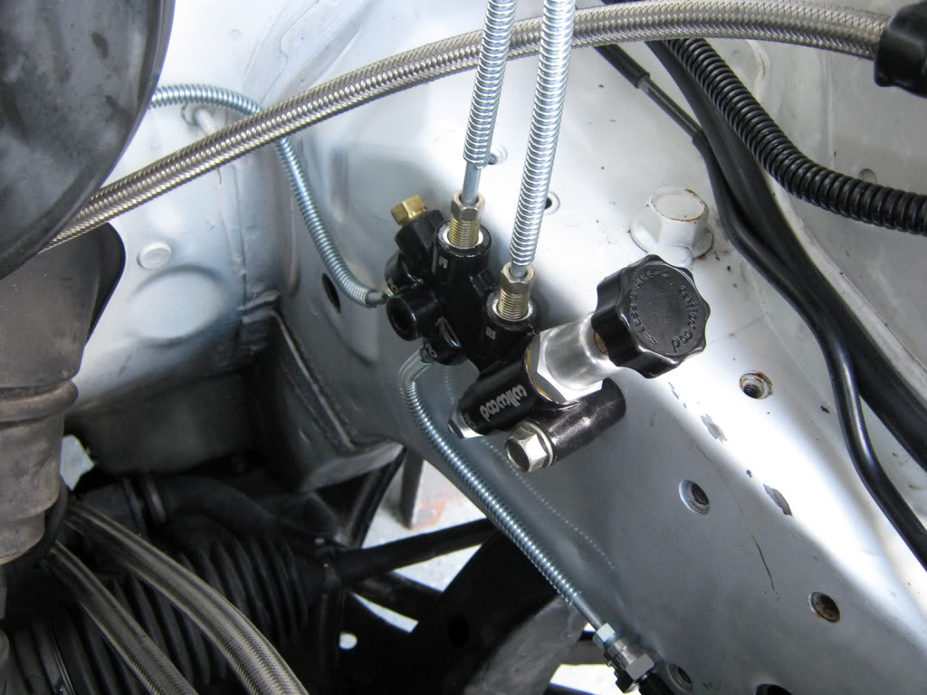

Still waiting on some AN3 Brake Lines, but the Bias Adjustment is installed.

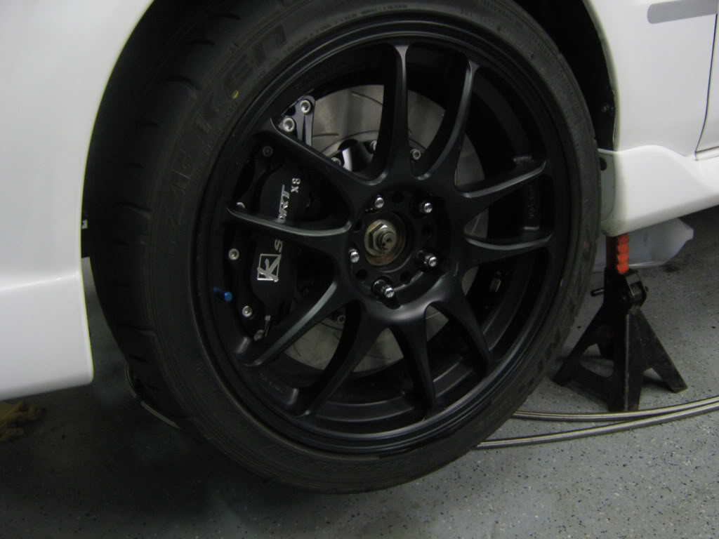

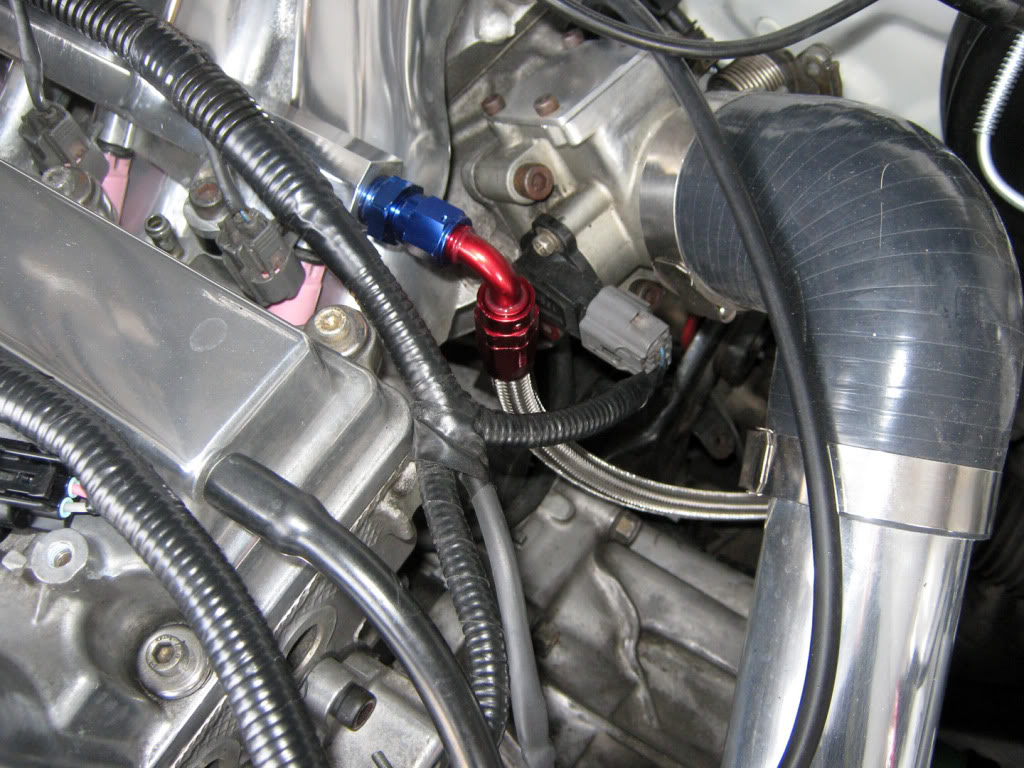

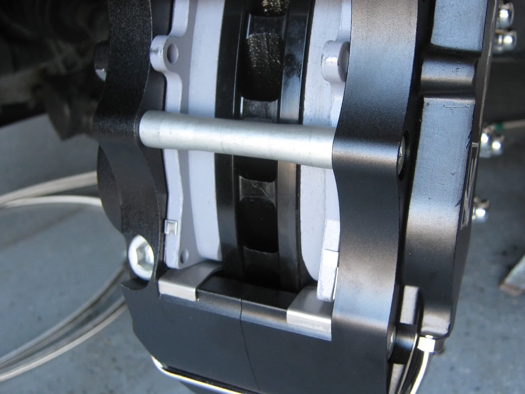

So I got some progress on the brakes. The front brakes are finished. The Rear are waiting on the Handbrake, but the remainder of the parts are here.
-AN3 Teflon/Stainless Braid Lines.
-Banjo Fittings
-Compression Fittings
-K-Sport Hydraulic Handbrake

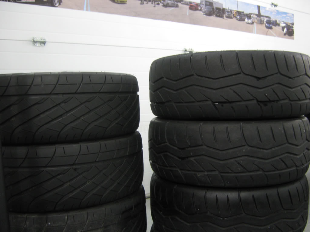

A Comparison of 4 215 Tires vs a 225 Tires
Quite a difference.

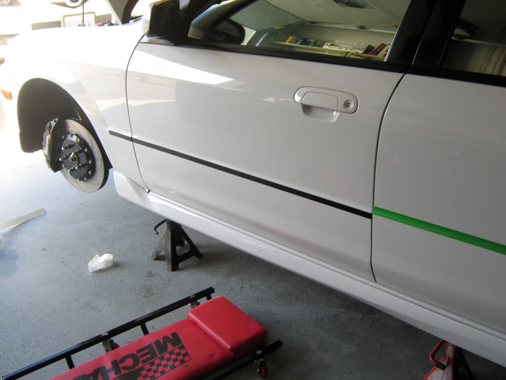

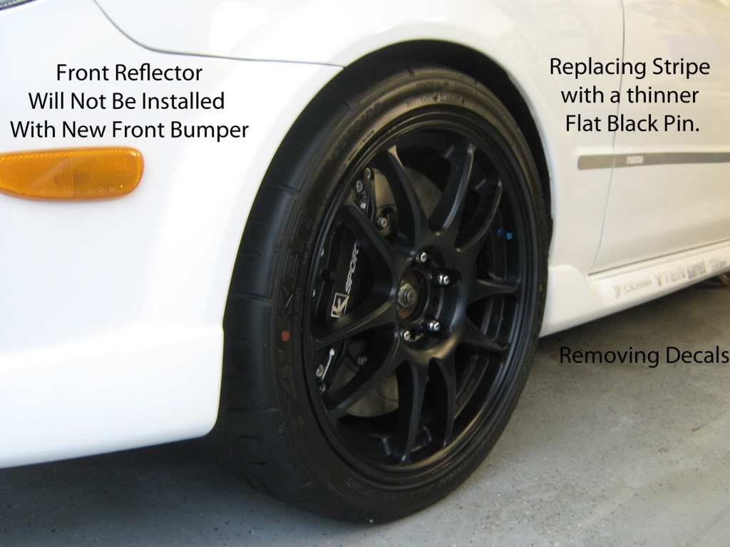

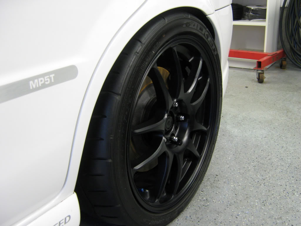

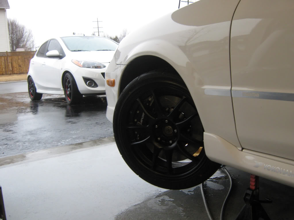

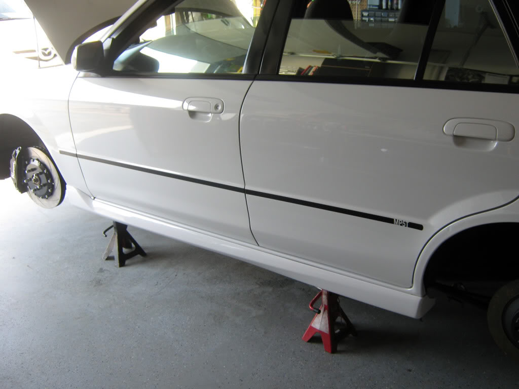

With the new Rims being Black, The MP5T is getting a huge face lift.

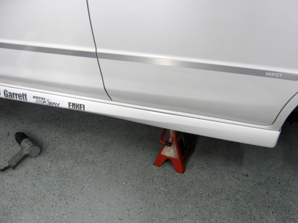

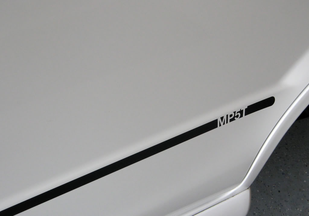

Silver Decals Removed
Silver Decal Replaced on Friday with a Flat Black one.
Silver Tinting is being replaced with Black.
Thank Christ for Goo Gone.

Today, Nothing too hard, more precise. and the Rims were dropped of to get balanced, so don't bother to ask to see it with the rims.
The car is going BLACK...
Oh and a Massive THANK YOU to Loudmouth Design and Printhouse in Ottawa
613 321-3353
They literally took a drawing and made EXACTLY what I was looking for.
Vinyl Decals in 24 Hours.

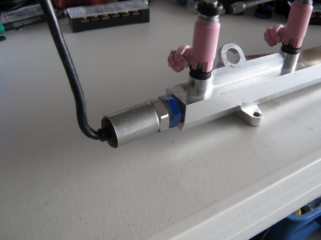

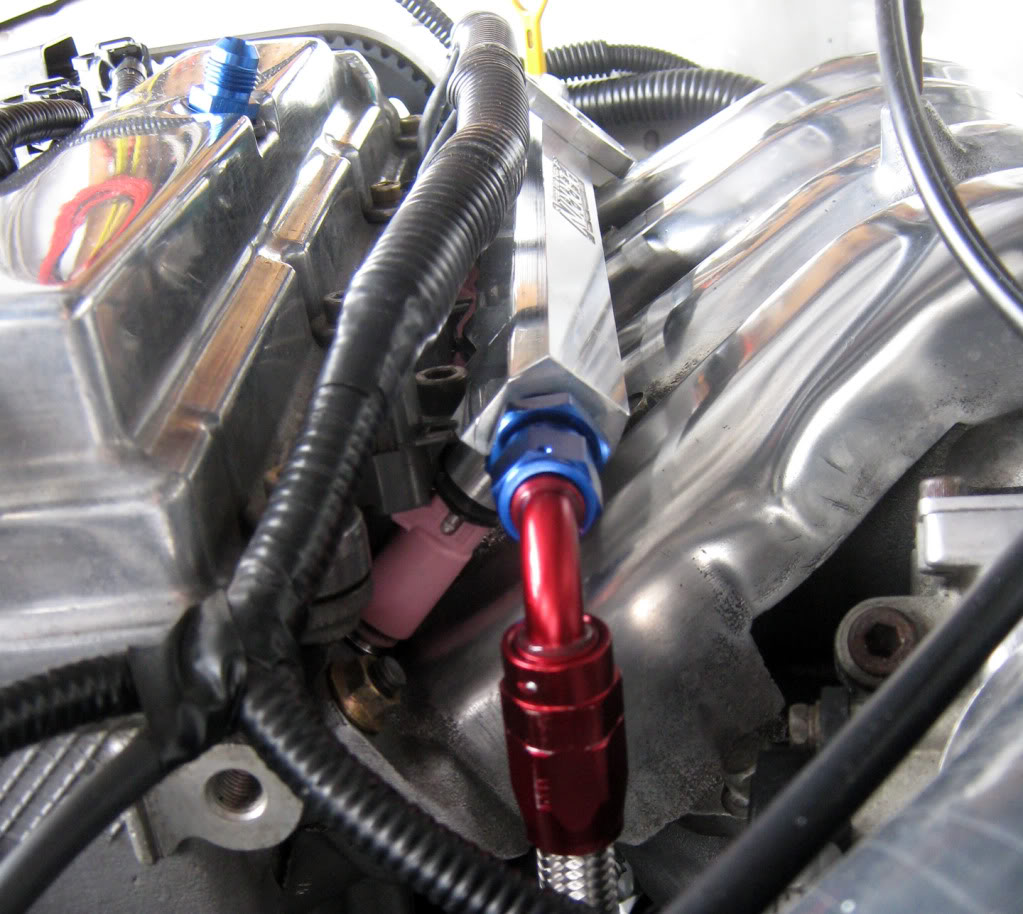

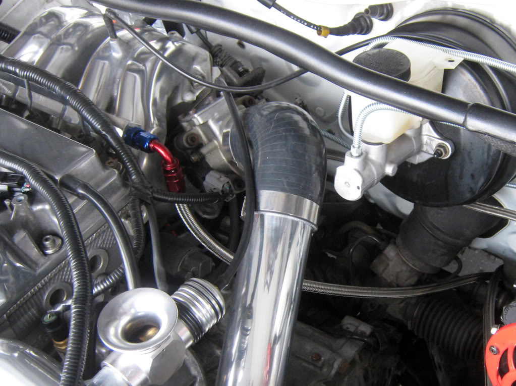

More work on the fuel system as I am waiting on some Brake Parts for the rear.
The AN6 Fittings were placed on the Rail, Plus the second fuel pressure sending unit has been attached to the rail.
I am impressed how "Beastly" the AN6 Looks, It's really huge and should be perfect. My Hopes are for a Leak Free test to 80 PSI Rail Pressure.

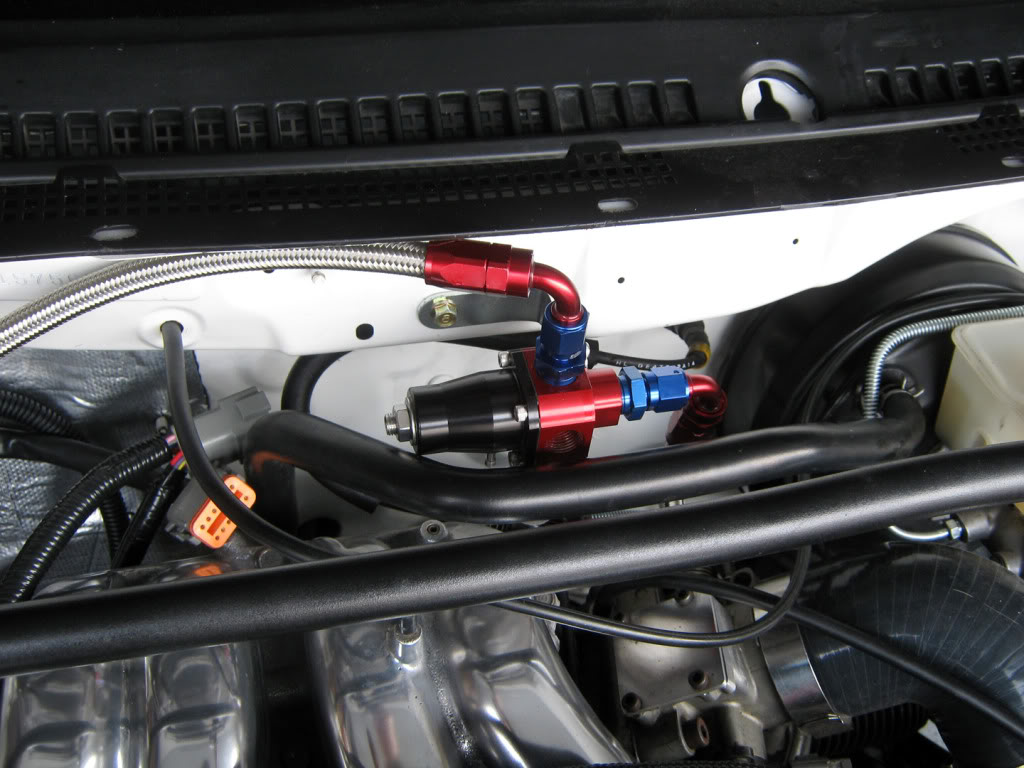

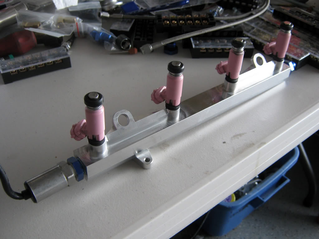

Found a Place for the FPR. Attached some AN6 Fuel System.
Waiting on 3/8" Plugs for the FPR
Waiting on Fuel rail adapter.

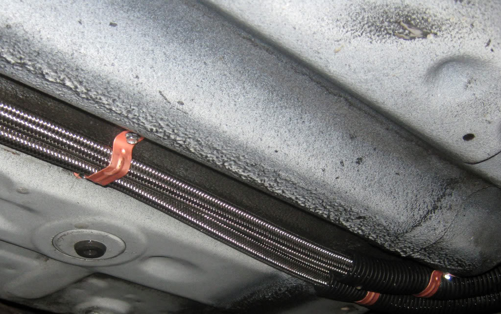

Started to secure the fuel lines under the car... Notice how clean it is for a 10 Year old car...
