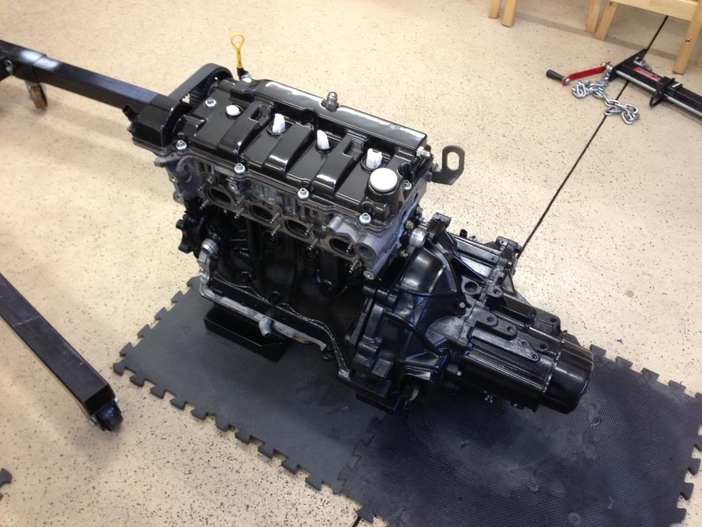

New trans was picked up yesterday and installed today..

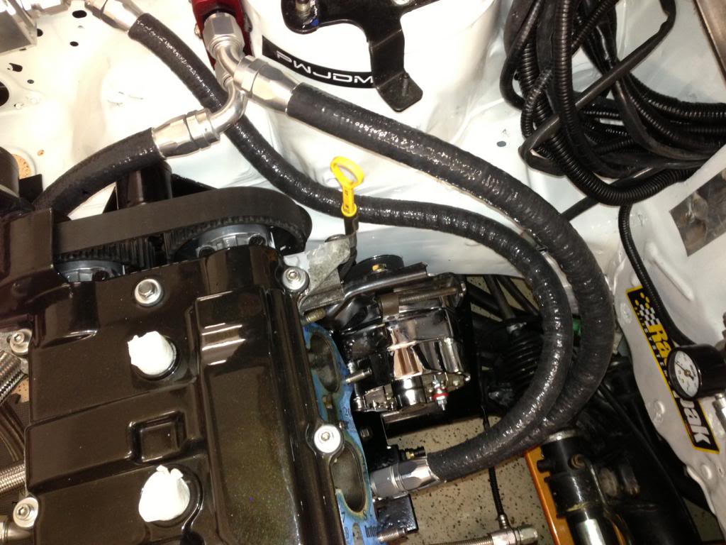

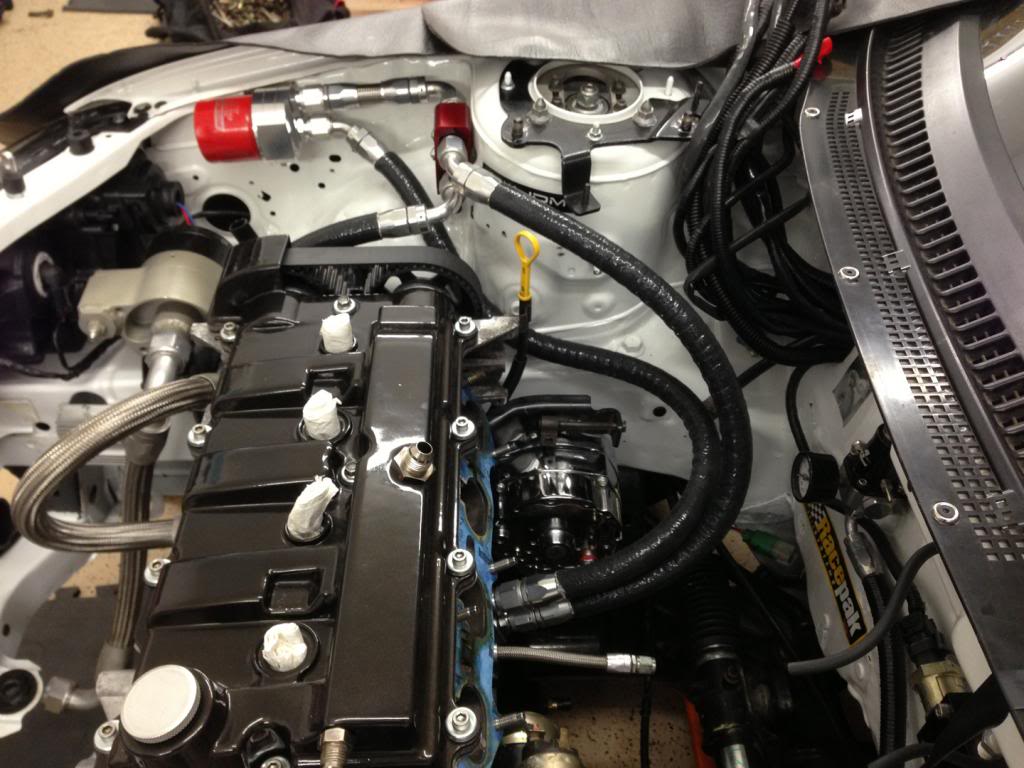

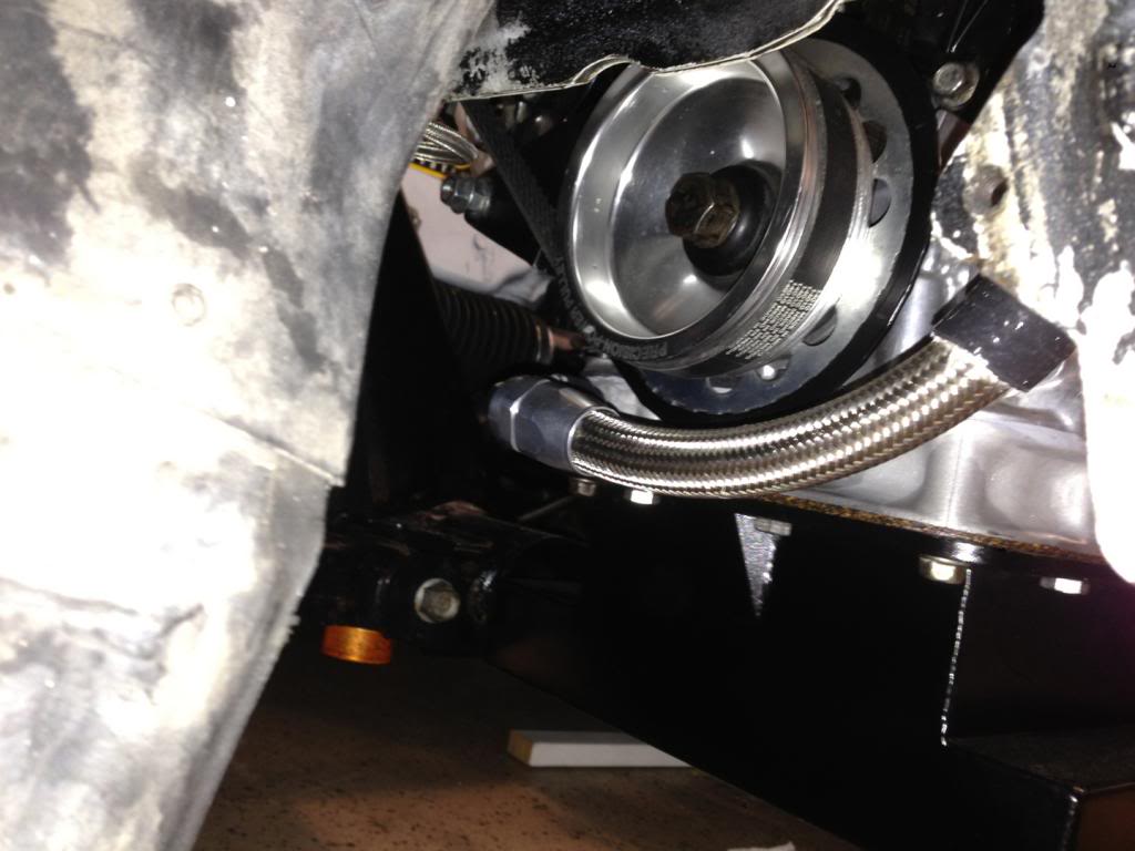

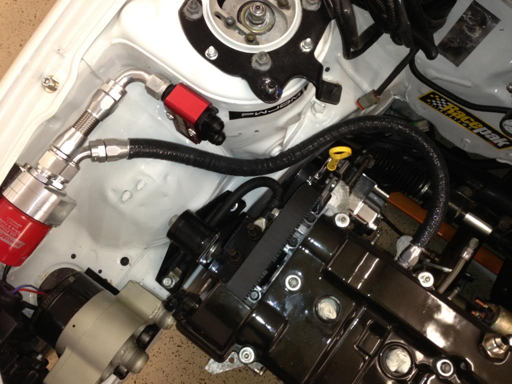

Oil System is in as well..
There is a hose that goes to the regulator
There is a hose from the regulator that goes to the filter and then back to the engine.
There is a hose that returns to the windage tray from the regulator (Bypass)
Super easy to add a cooler, just cut the line, add some fittings and bolt on a cooler.

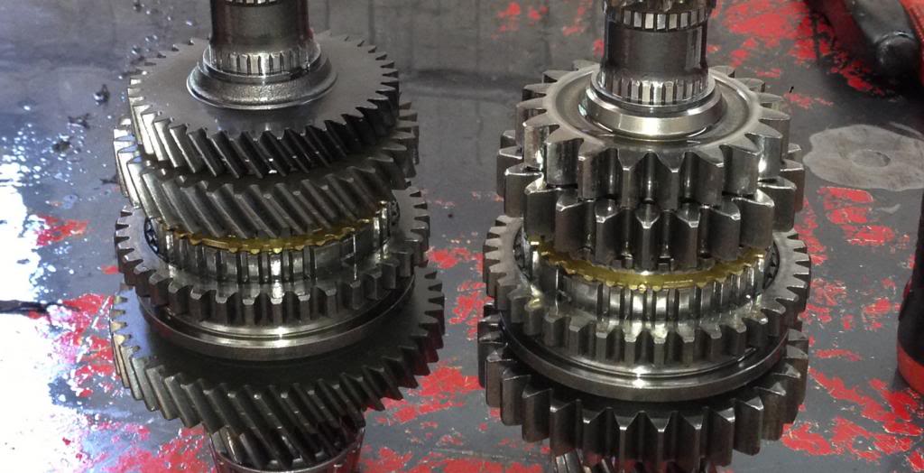

Some Random shots.
it's on the road again and running well.
Some minor issues that needed fittings adjusted/tightened.
Snagged a shot of the OEM Transmission compared to PAR.. Holy Crap!
