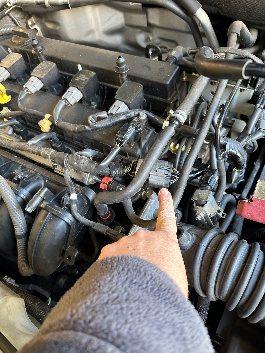

Hello all
I am brand new here and have been searching the web for answers and cannot find anything so thought I’d ask here as you guys and gals all seem pretty knowledgeable.
I have a Mazda 2009 gh wagon and the battery went flat over night - not sure why as not lights etc where left on
the battery window is red on the battery and I have trickle charged and still red so presume need a new battery however the advice I need from you guys if possible is a s follows
Battery went flat and car wouldn’t start then when
The car is completely off and no keys in it or anything and been sitting for ages so there is no risdaul power - and battery flat anyways and there’s a pump or something running
Have followed it back and it looks like it’s a switch that runs fuel to the fuel rail and injectors
I unplugged it and it stopped the noise
Jumped the car and it started
Turned it off and that pump thing is running again and won’t stop
any ideas anyone has would be great
