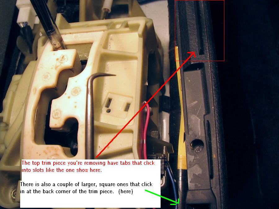

First remove the trim piece around the e-brake. Best way is to remove the 'thin' side first. That's the piece to the left of the handle, closest to the drivers seat. The piece your trying to remove has a couple of tabs that snap into corresponding holes. A great tool for this is a putty knife with a layer of masking tape around the edge of the blade. The trim piece will come off very easily, but it's still nice to have. (the attached pic is old, but I can still show you the kind of tabs/connectors you're working with)

After you've removed the trim piece in the first paragraph, you're ready to move the one around the shifter. It's also held-in with tabs, but also has two square locating posts, one at each back corner next to the piece you previously remove. Be advised, these two tabs are the toughest, and having something like a long, skinny #1 screwdriver, or an awl or pick is the best way to 'open' them
