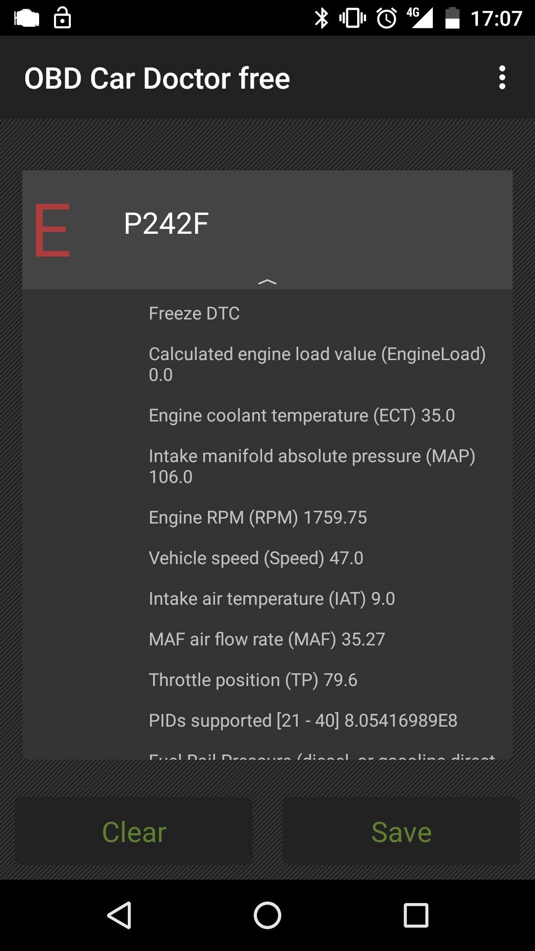

Long story short: Bought a used Mazda6 2.0D (89kW), about 110k km on the clock, loved it, it stopped working, barely any power at all with bad idling, DPF seeming the perp, broken seals were found and fixed, car still didn't work, manually took the DPF out and cleaned it with DPF cleaner fluid, Discovered that the EGR was stuck in open position, cleaned it, still stuck with a flashing DPF light and about 60-70% power. It's all about Track Errors. Borrowed an OBD2 scanner, found this fault code.

Does anyone have any idea what more I could check? I have already ordered another bottle of the cleaner fluid, but I'm trying to explore other options, as I want the car ready for a road trip in late February, and things tend to go slowly with my father working and me studying.
I'm also kind of wondering if the Air flow rate is normal at that throttle position and rpm. Hard to find a good reference point.

I've been driving it for a few weeks now, and it's pretty stable at this point, at the 60-70% power DPF flashing level. A friend of mine casually mentioned he had an OBD2 scanner lying around that I could borrow. So I plugged it in, read the 1 fault code that was in there (the added picture), cleared it, and found it again the second I started the car. It popped up as soon as I turned the ignition, and registered with a lot of 0's. Is that normal?
I'm going to have to clean the DPF first, that's for sure. If I bring the car in with the p242f fault code they'll think I'm stupid, and they'll offer me to get me a new DPF, and/or send me on my way. Not to mention that the closest Mazda dealership is 2 hours away, so I want the trip to be worth it. x)
