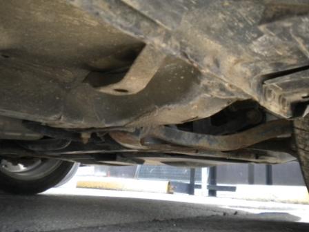

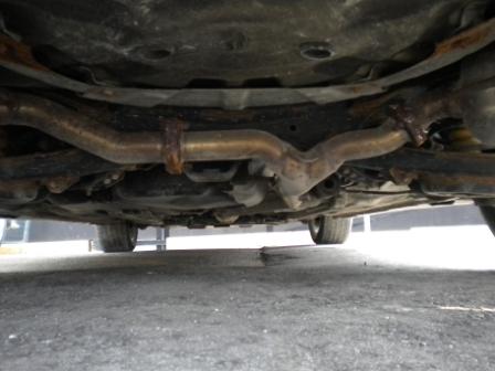

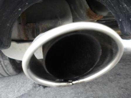

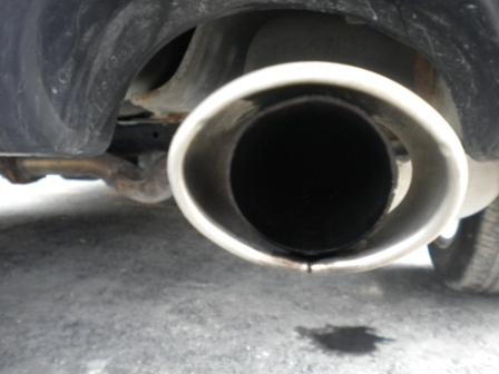

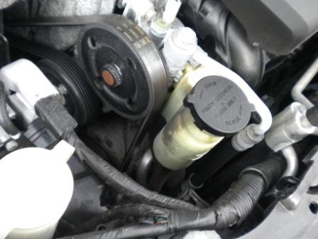

I am planning to buy a used 2007 Mazda 6 i touring edition. It has about 60k km and sells for $13k Canadian dollars. This is bought at auction by the dealer.
Before my test drive, it took a few sec to start the engine. The salesperson told me the battery almost ran out. How long does the battery usually last? The interior panels are loose. The relative position of the left exhaust tip isn't the same as the right, and it seems to be damaged. The power steering fluid seems dirty.
The pictures are attached. Thanks for your advise!
Attached Thumbnails Should I buy this used Mazda 6?-dscn3364.jpg   Should I buy this used Mazda 6?-dscn3366.jpg   Should I buy this used Mazda 6?-dscn3367.jpg   Should I buy this used Mazda 6?-dscn3373.jpg   Should I buy this used Mazda 6?-dscn3369.jpg

Show me the CarFax (do they have that in Canada???)! It has been the experience of many - myself included - that the stock battery is garbage. This, however, is not a Mazda specific issue as owners of other cars have had similar experiences. A good battery should last a long time. With regards to the particular car you are asking about, I don't think I'd by it. Looks like there are some indications that it may have been involved in an accident and there is deferred maintenance. I'd keep looking.

The dealer showed me Carproof, and it is clean. However, not necessarily all accidents and incidents show up. The line in the side picture of chassis is not straight. I am not sure if this is a structure damage or the previous owner hit the chassis on curb.

Batteries last 3-4 years. Power steering fluid should be changed as well as coolant, brake fluid, automatic transmission fluid. Tail pipe can be adjusted (make it part of the deal).

As far as the possible accident is concerned: to find the damage you would have to measure the body against the factory specs on a frame rig (I don't know the exact term for it) at the body shop. At least you should drive it after adjusting the tire pressure of all 4 wheels and checking for pulling left or right on a even and straight stretch of road while there is hardly any wind. Most roads are crowned and a perfectly aligned car will pull slightly right. So you need to go on opposite lane to see if it pulls slightly left while avoiding a head on collision.
How dramatically could you squeeze the price: 1 set of tires (a curb jump is likely to damage them), a body alignment check and a 4 wheel alignment. Find out the typical cost of these and have fun looking at the dealer's facial expression of disbelieve!
