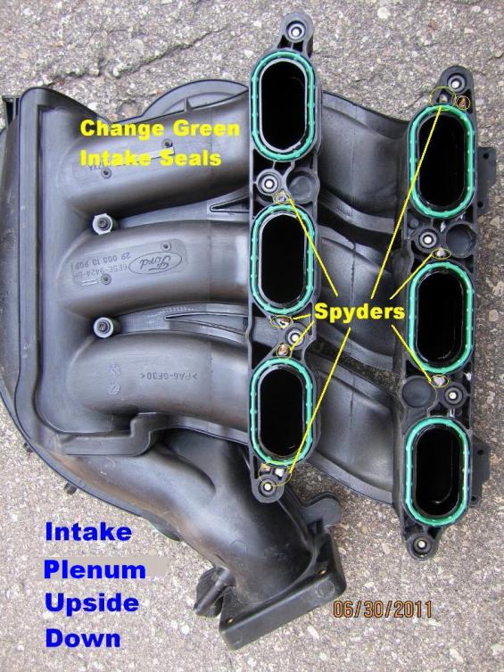

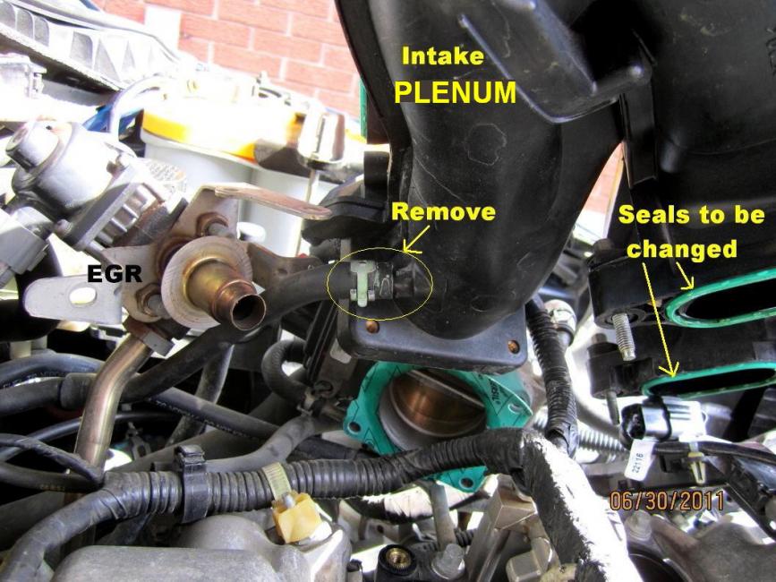

Originally Posted by xericx
Are those under the engine cover? NO I recall the mechanic saying to replace them since they looked like they cracked and there was some oil there? Would that give me a lean condition?
Is it costly for them to do? He said the rear ones were harder to get to.
That's an oil leak.
See post 63 for link to see engine intake plenum seals. They are under the Black Intake Plenum (first thing that comes off -- your EGR valve also attaches to it. See pic from underneath (6 green seals).
OES Genuine W0133-1639826 Intake Plenum Gasket | Auto Parts Warehouse
I'm really racking up the post count with all these double posts on this thread. Please re-read everything.
Attached Thumbnails Running Lean P0145 + P0141, already spent 0 trying to fix-intakeplenum1.jpg   Running Lean P0145 + P0141, already spent 0 trying to fix-intakeplenum3off.jpg
