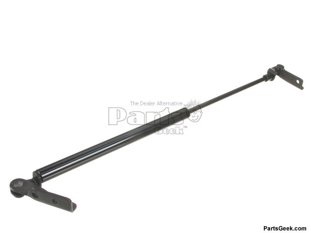

That's interesting that the struts on the MPV have specific left- and right-side parts. The struts on the 6 are the same on both sides. I did a bit of Googling and found this pic of an MPV strut:
The mounting mechanism looks completely different. If this pic matches what you've bought, it looks like you'll need to remove 3 screws/bolts on each side and that's it. Go ahead and post a pic of your strut mounting points here if you would like us to double check for you.
In terms of replacing both at once... if you know that one strut is faulty and the other is definitely OK, you can just replace the faulty strut. Otherwise I would err on the side of caution and replace both.
