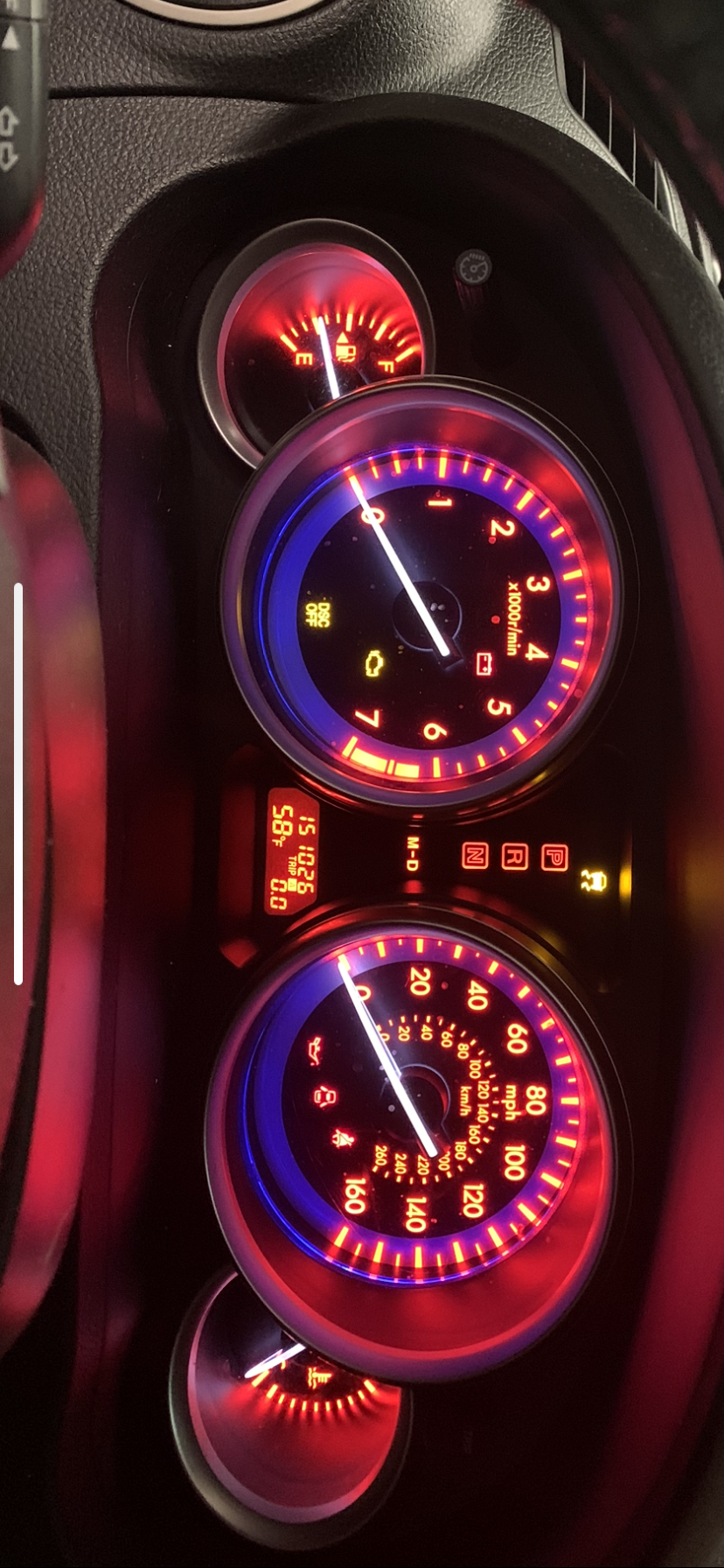

So I took my battery and my key fob into O’Reily’s. Car battery was good and I got a new battery installed in the key fob. Still no crank and no start. Here is a picture of the dash lights. Am I missing something simple?
