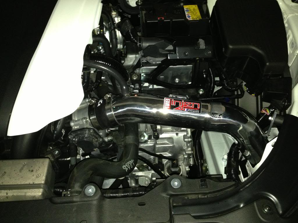

Drove home from Injen tonight and YES, you can feel the power. 0-60 came quick with great pick up and 60-80 was even faster. After the drive, I popped the hood and the tube felt super cool. The sensor placement has changed, the bends are different, vacuum hose bung seems larger, and filter seems larger. Here are some pics.

There are pros and cons to everything. You know the pros are the power from getting at that colder denser air.
I see they narrowed it and straightened the area by MAF sensor!
Here are the cons.
You can't go thru an automated car wash as the filter will saturate with water.
You can't drive thru puddles as it will splash off the front of your tire and saturate your filter especially if you have slot openings in front of your tire in the wheel well.
You can't drive it in the winter if you have lots of snow.
The last one is why you need to input your country and state. Please read and do: https://www.mazdaforum.com/forum/new...-avatar-30905/
Possible damage due to above: soaking the MAF sensor as well as filter. Going thru deep puddles (you know those idiots going through a flooded street) could result in sucking in mass amounts of water destroying your engine.
You can install a deflector shield. For what i'm talking about watch this video:
