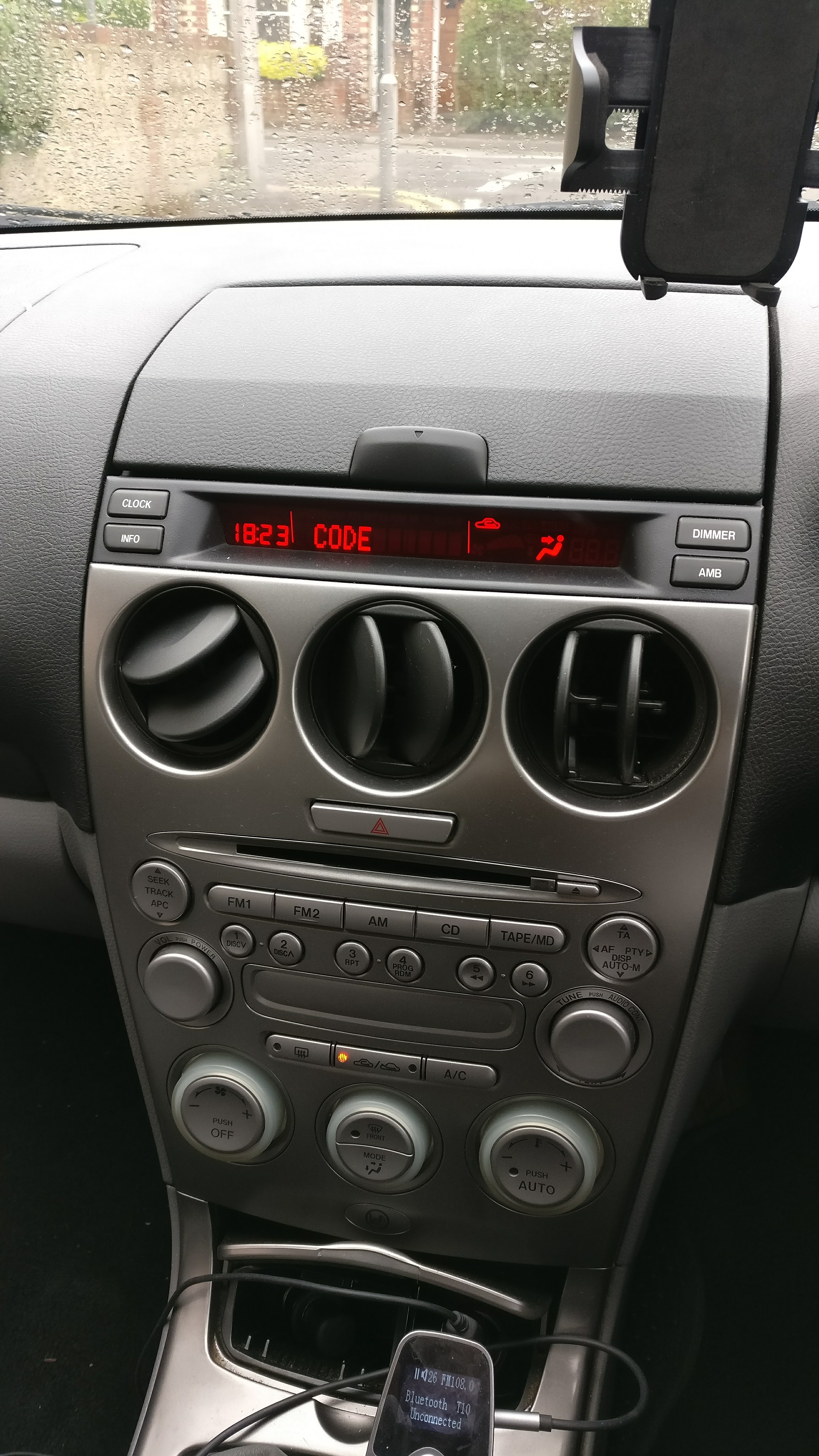

Hi all,
I tried to find a way to enter the code of my autoradio (following a battery outage) after being prompted to do so. Despite clikcing on all the button and trying to find on the web how to enter any code (I found a way to enter the constructor code), no joy. Please see image attached: I have the "code" text flashing.
Simple question, I hope: how do I type the code?
Many thanks,
Swann

Default How to imput code
Hold down >>6 and DISP Auto-M buttons together for about 10 seconds, four dashes will flash. Then use these four buttons -Disc1, Disc2, 3RPT, and 4Prog RDM to impute your code, & then hold down >>6 & DISP Auto-M buttons together again for about 10 seconds and your radio will work again. I hope this helps. Keep me updated.
