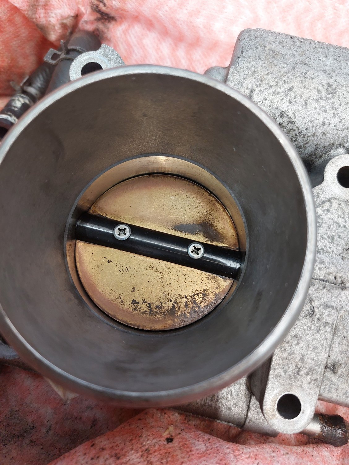

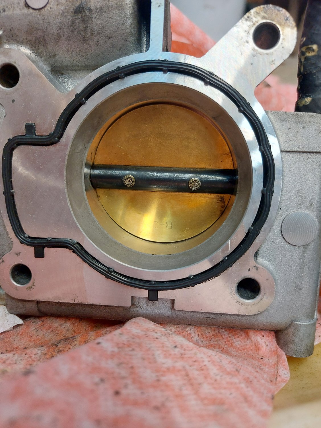

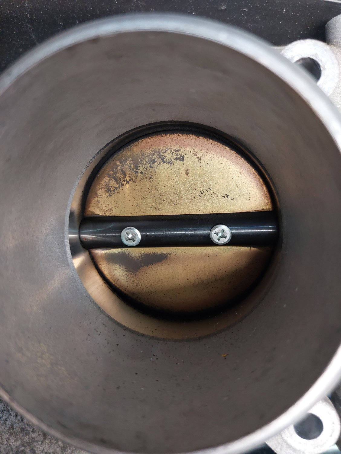

Hello again grim! (You helped me before in these fora when I first bought this car 4 of 5 years ago! And I'm also in NZ). I haven't done the MAF but I have cleaned the throttle body - maybe I'll do the MAF if the problem isn't solved. I'll put pics below. Judging by the condition of it you might be right/have solved the problem.
As stated in the OP whenever I reset the ECU it gets better for a while, so I'll know in a week if it has solved the problem. But already it drives perfectly. One thing that is noticeably better is that I'm sure there is a little slack in the drivetrain - I think the gearbox somewhere as there is a perfectly reasonable amount of slack when I rotate the wheels when up in the air - which is most noticeable when going from slight engine braking to on throttle and vice-versa. This feels way better now, I think because when off throttle the engine isn't trying to idle so low.
One question I have is, how in the sam hell does carbon build-up occur in the engine intake. I mean, it's the intake!. Before engine filter, no problem. After filter, no problem. MAF sensor, no problem, Rubber duct to throttle body, no problem. Throttle body and south, problem!
Interestingly some tarnishing on the intake side did not come away. I would have thought the opposite would be true, but maybe the carbon build-up actually protects the engine-side surface from....windage damage, maybe. I also thought that when cleaned the butterfly might sit completely closed, but this did not happen. Obviously it is designed to be slightly open when 'closed'.
