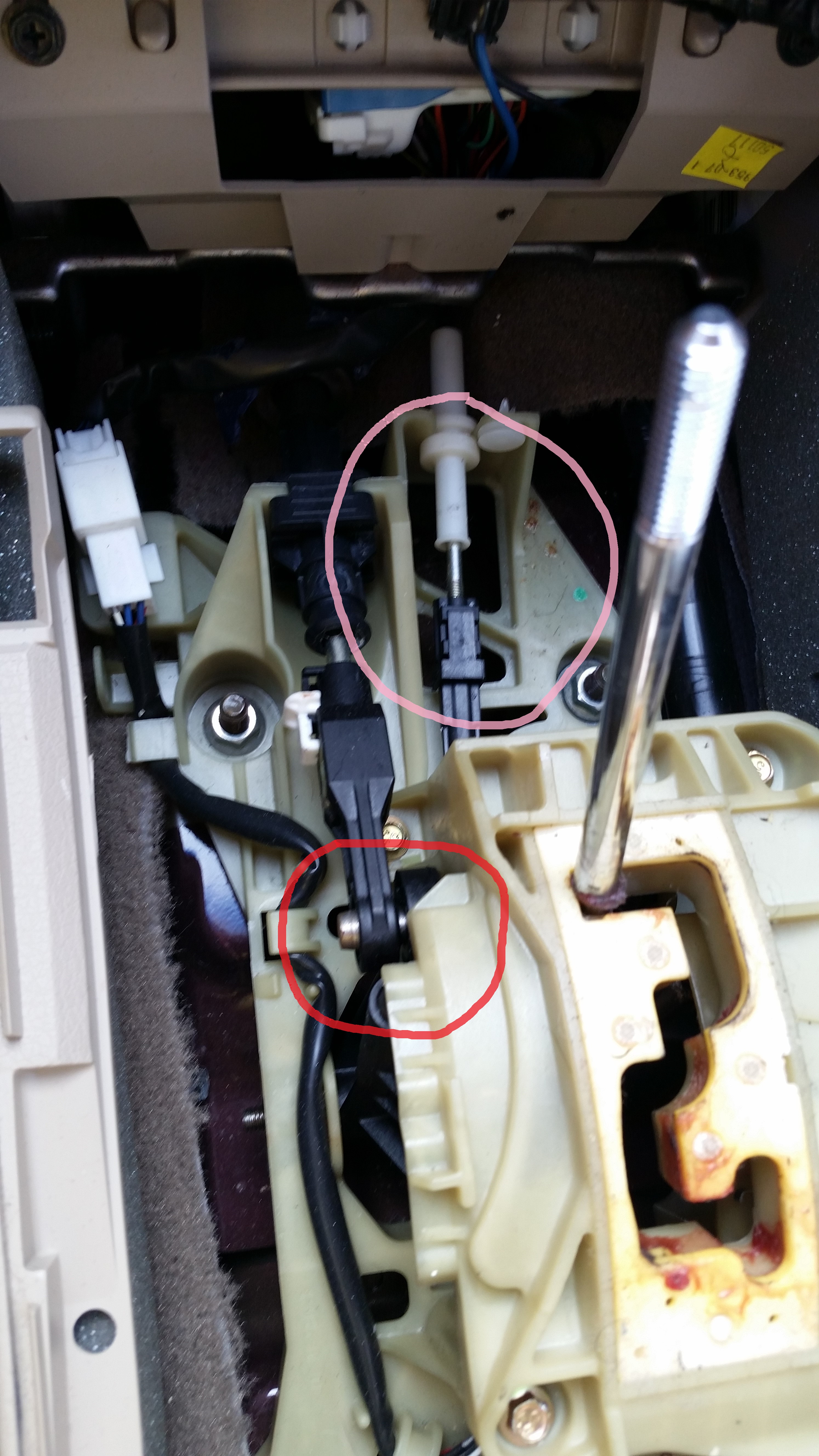

Now the last few days i have had no issues with the car starting. I did take the console apart, are you talking about cleaning the area i have circled in red?
Also i noticed when the shift lever is in park and you move it directly to the right, the piece i have circled ink moves, would that have any impact on the starting?

Alan, been so busy lately I have not had the time to even look at my computer. The ball socket to clean is on the other end of the cable, transmission side. The two cables in your picture, one is the shift interlock. When you step on the brake, that cable activates and allows the shifter to move. It only moves a little bit where as the one for the transmission moves constantly with the shifter. Recheck the cable end on the trans side to make sure it moves freely and is not binding up when you try to put it in park all the way.
