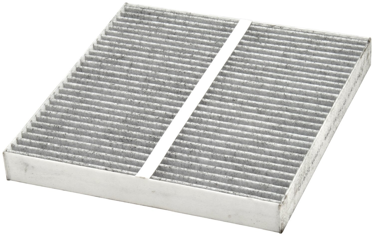

I finally installed it today without any tools! Leaves all fallen, snow outside, snow tires on for a few weeks.
Installed a ATP # RA-15:
ATP RA-15 Carbon Activated Premium Cabin Air Filter : Amazon.com : Automotive ATP RA-15 Carbon Activated Premium Cabin Air Filter : Amazon.com : Automotive
