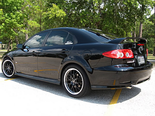

well that's good news, in a way. that's less money to spend. question about those mazdaspeed springs. mazda says they lower the car 37mm, is that at all noticeable do ya'll think? especially for when I get new wheels
Old Aug 27, 2009 | 09:36 PM
CKeffer's Avatar
Joined: Jun 2007
Posts: 640
From: Houston, TX
This is more or less how the car will sit on the mazdaspeed "hatch/wagon" springs with 18" wheels & 225/45 tires (the car has settled out a bit from here, but not much, it's and even 2 finger gap front and rear).

Old Aug 28, 2009 | 12:20 AM
Triple G's Avatar
Joined: Aug 2009
Posts: 9
From: L.A., USA
Originally Posted by CKeffer
They will fit, only problem you will run into is that the shocks will wear out faster, but this is going to be true for any shock on a lowered car. Those are actually the set I have on my car and they are awesome!
Good to know...I'm thinking those just might be my next investment. What would you estimate the approximate lifespan of those shocks to be? I figure I'll probably keep my 6 for at least another 4-5 years minimum, and I average about 10-12k miles a year.
Nice ride, btw...is that yours? I dig the black with black rims. Is that the stock antenna mount, with the antenna itself screwed out? Personally I couldn't stand the stock horse-whip, and replaced it with the shark fin. Looks way better, IMO, and less like a radio controlled toy.

Holy giant pictures, Batman!!!
37mm=1.46", which if the car settles that much, is quite a bit.
Old Aug 28, 2009 | 08:29 AM
ginia's Avatar
Joined: Nov 2008
Posts: 102
From: Birmingham, AL
that looks good. very shiny! haha. does it ever rub on bumps and anything else? those would be 1st choice cause it won't void my warranty
Old Aug 28, 2009 | 09:36 AM
  #20
CKeffer's Avatar
Joined: Jun 2007
Posts: 640
From: Houston, TX
Yes, it is my car, and the antenna was out cause I had gone through the car wash about 5 minutes before taking that pic. As for rubbing, yeah they did, just a little till I rolled the rear fenders. Sorry for the giant pic, I'm used to forums resizing the pics with a message at the top (click for full size) and am too lazy to go and resize it just for this board. With stock wheels it shouldn't rub or if you can find a 7" wide wheel with a similar offset to stock. But seeing as that is pretty near impossible, you are more than likely just going to have to roll the rear fenders.
