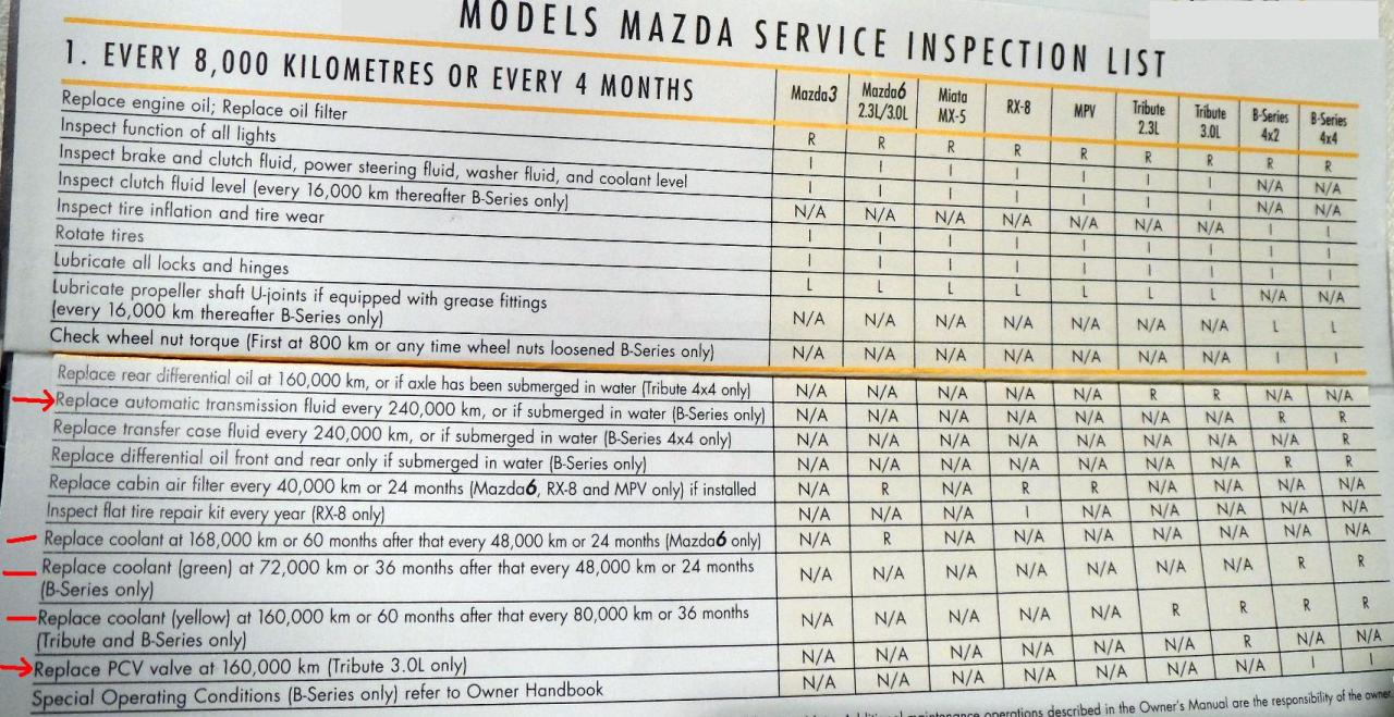

Not according to this manual from Mazda. 168,000 km OR 5 years. And it says Mazda 6! After that every 2 years! Know your stuff, the excuse of it being different in another region is getting old. That works for emissions, not for main stuff like coolant and engine blocks which are pretty consistent.

WOW! Sounds like a good excuse, why don't you post a picture of the 2006 scheduled maintenance for Australia, so we can see if you are telling the truth. Not some schedule for 2012. Doubt Australia is any different than USA/Canada.
My honest opinion of these maintenance items is that they are too late, and should be done sooner, perfect example on this sheet (that I was given when I purchased my Mazda 6 in 2006): transmission fluid and PCV valve. All manufacturesrs are pushing the limts so they can claim "low maintenance".
According to this schedule, the automatic fluid should never be changed on a Mazda 6 Automatic transmission. That is the most ridiculous statement i've ever heard.
You nead to read this article that discusses auto tranny fluid temps and longevity and they zero on 1 that says it's good for 100,000 miles: http://trucksplusauto.ca/transmission-fluid-flush-tips
Here is a quote from that article: "As a rule of thumb, every 20 degree increase in operating temperature above 175 degrees F. cuts the life of the fluid in half! At 195 degrees F., for instance, fluid life is reduced to 50,000 miles. At 220 degrees, which is commonly encountered in many transmissions, the fluid is only good for about 25,000 miles.
According to the Automatic Transmission Rebuilders Association, 90% of ALL transmission failures are caused by overheating. And most of these can be blamed on worn out fluid that should have been replaced. On most vehicles, the automatic transmission fluid is cooled by a small heat exchanger inside the bottom or end tank of the radiator. Hot ATF from the transmission circulates through a short loop of pipe and is thus "cooled." Cooling is a relative term here, however, because the radiator itself may be running at anywhere from 180 to 220 degrees F."
If this is the case for an automatic tranny fluid that never needs scheduled replacing, according to Mazda, what is the reality for coolant!
I am warning all car owners, get your maintenance done sooner as opposed to later. You know the old saying "Pay me now, or Pay me Later". Usually the later costs more money!
Attached Thumbnails Cooling fan keeps running-motor hot-mazdaserviceschedule.jpg
